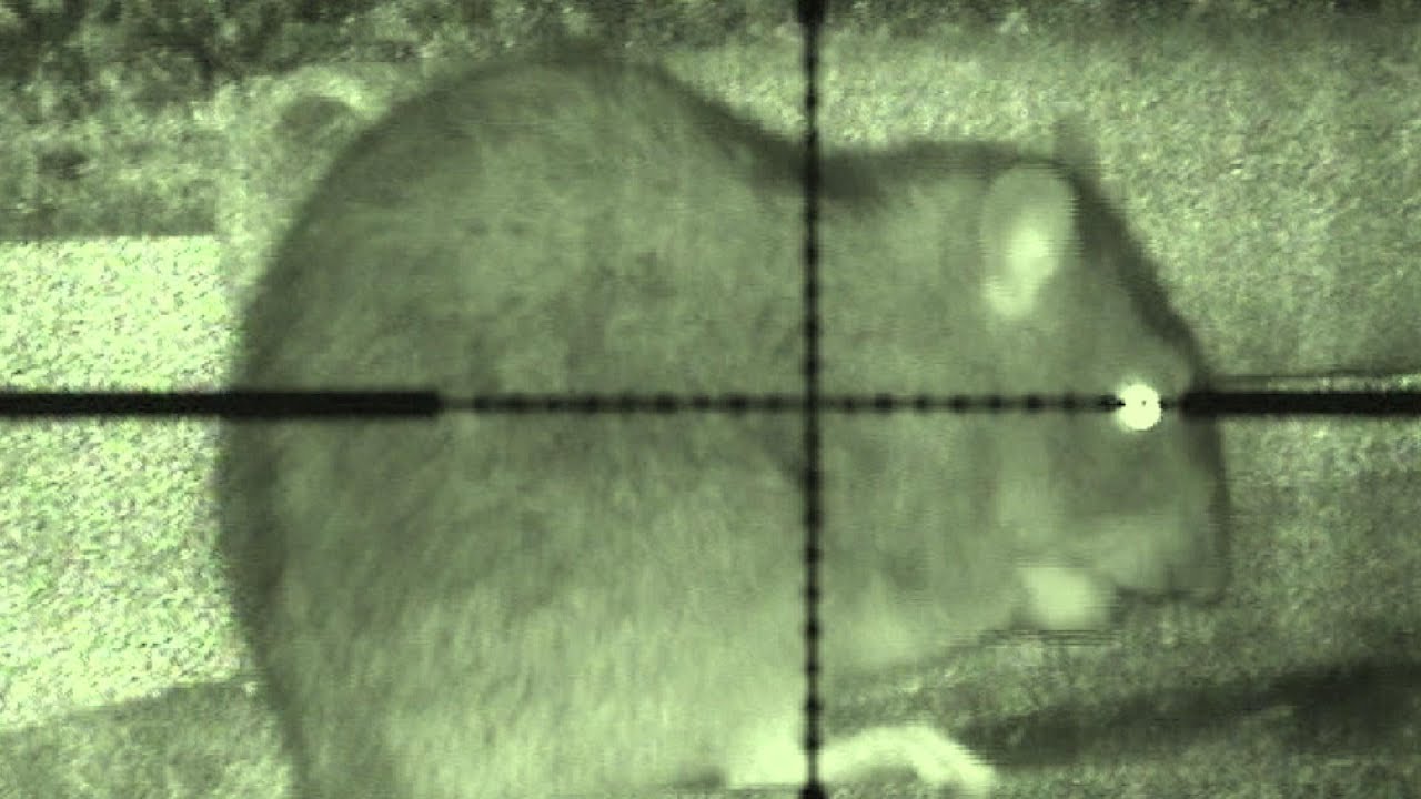

I found this guy on youtube. A bit crazy - but really thorough.
His setup went from a “lego” version 1.0 to a full digital “scopeless” version 3.1 in two years
Great thing is he has put a parts list in the description of the videos.
I really like the v1.0 as it is within my budget. But any thoughts on improvements and so on would be nice.

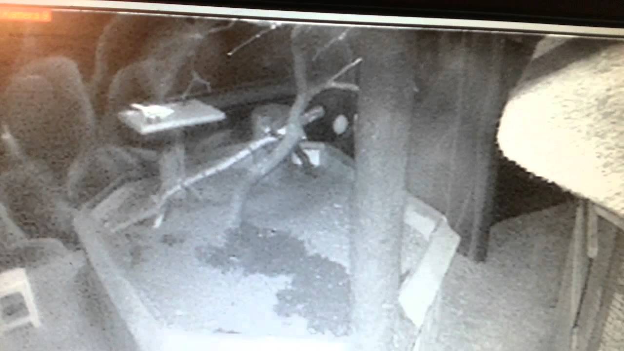

Anyway here is a horror clip from our surveillance cams a couple of days ago, which made me order the stuff Roland suggests:
