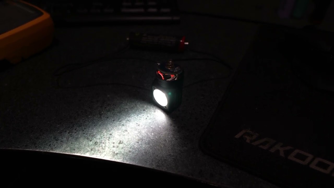

I have removed the tube off my H04 and connected the battery via wires soldered onto the driver. I’m going to get some confirmation on these claims instead of looking at runtime graphs, I have my DMM to monitor the voltage on load.
I’m running it on H1 and will see when it starts flashing and whether its stepped down or not as the graph shows above

I ran a test just now with leads and checking the voltage on load.
The above graph isn’t accurate for the H04 series, Skilhunt must have tweaked it if what you show above to be accurate for the H03.
Cell used Epoch 3000mAh which is close performing to the 30Q
Test ran on H1 level
Dimming started at 3.07v
3 quick flashes to off every 30 seconds starts at 3.00v
light cut out at 2.694v
time from 3.00v to 2.694v was 31 min 17 sec
After the cell was left sitting for 5 minutes the voltage climbed to 2.79v
