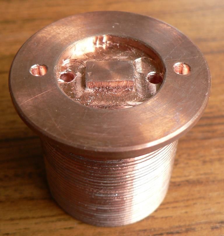

A new thread will be started whenever this build is completed. I've had bits built for weeks and instead off me looking at them everyday, and not doing anything with them thought I would give you a sneak peek. Thanks to some members here for advice when needed.

Wow. That is something else! Love the heatsink/star combo, not sure heatsinking can get much better
Is the pill for the Defiant ST? Can’t get much better than that monster pill as far as heatsinking goes.

You have a mill now? I'm extremely jealous.

Nice machine work! Looking forward to more info on the project!

LOL. No, I dont own a mill. I have a vice that goes on in place off the tool post. I stuck an end mill in the 3 jaw chuck and went from there. I dont have any sort of graduations on the main saddle longitudinal travel so had to use a texta mark to tell me how far to travel in. Next time I will clamp a piece off wood across the bed to stop at the right depth.
Nice square corners in the star cutout. How long does it take to cut that many threads.

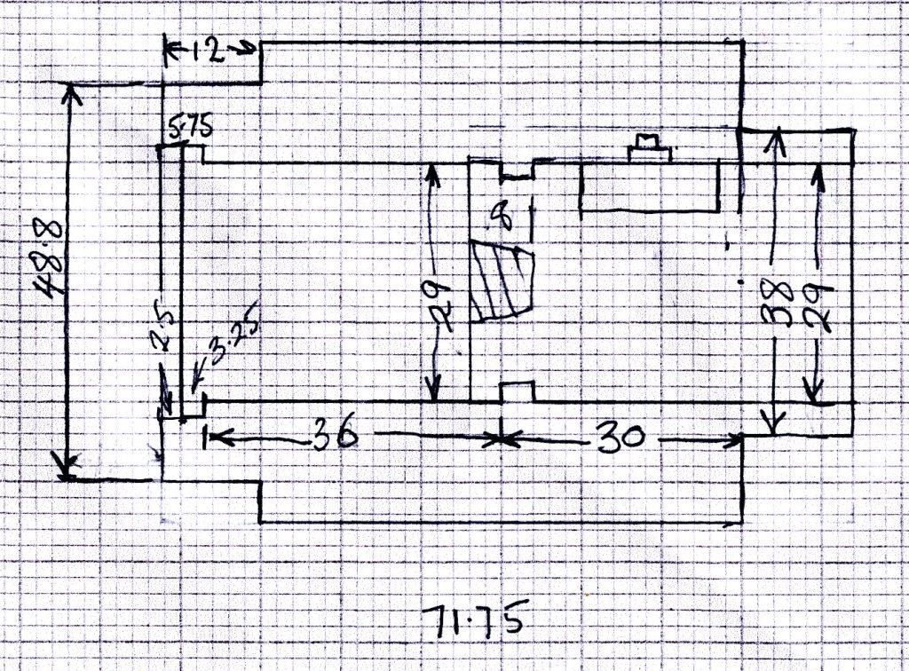

I tried cutting this thread one with only a couple off cuts. Unfortunately the first cut looked liked it had been chewed out by one off the dogs. The rest off the cuts was try to save it mode. I haven’t made the heat sink yet so will just make it to suit the pill. The heatsink is what I’ve drawn up. Hopefully it will have the switch in it but so was my last one and what did it end up with? You know how the best laid plans go. That star is my second attempt. The drill was blunt and wondered off on the first one. I could off used it but I would off never got over the ribbing you would off given me. Thats what happens when your slack.

I really can't wait to see this monster come to life. That copper heat sink is very sexy. Well, anything copper is sexy to me.

ooh, very tasty looking piece of machining and I really can’t tell where the dog chewed it. That’s going to make for one sweet light. The Undertaker on mtbr diy light forum did a similar pedestal/ star heatsink for his MT-G2 lights which seemed to work really well:

Direct thermal path,just got a new meaning. I have seen similar stuff before, I think, but cant remember nothing as sweet as this!

Thanks for the link. I have seen this post before which sort of pushed me to do what I’ve done instead of a round hole. What some off those blokes do blows me away. They must have far to much time on there hands.
