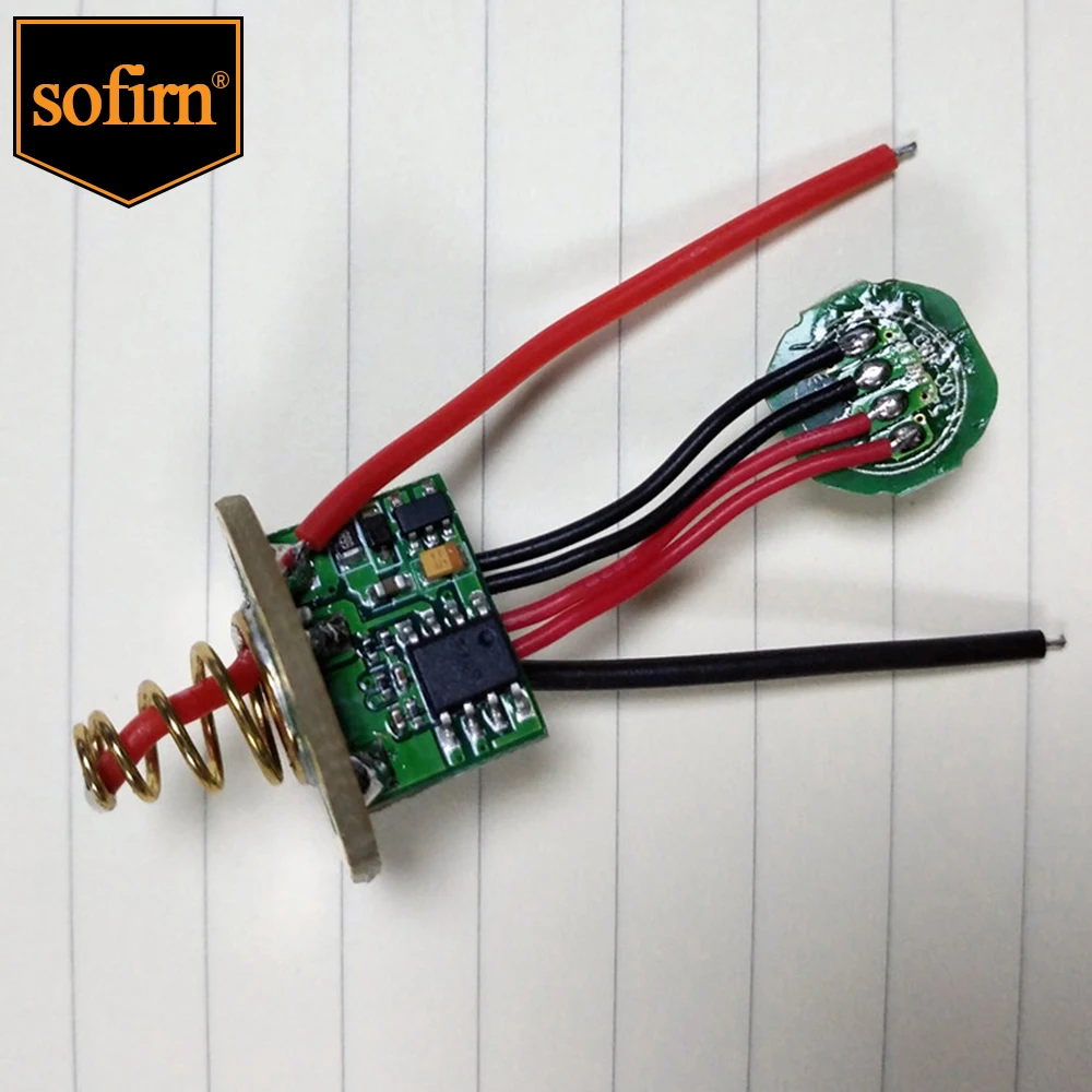

You can purchase the driver separately from Sofirn:
Sofirn Flashlight Driver Circuit Board Chip for SC18 Q8Plus LT1S SP40A C8G SC31 Pro IF25A SP33V3.0
Yeah, if checking the datasheet they aren’t really good for that kind of voltages and currents. Resistance shoots up wildly under 4V causing increasingly more heat.
Yeah, I noticed that too a few days ago. Not cheap (partially due to shipping cost), but good to know that it’s at least available. Makes that I feel a little bit better about trying to push the Q8 Plus a little bit harder. (By at least installing spring bypasses.)
Yeah, DB_Custom/Dale also mentioned in his topic that the original FET’s are mediocre quality and swapped them out for better ones. I don’t have the knowledge to determine which suitable FET’s are better quality, but maybe I will try to find the same infinion FET’s that he used. (I can read the ā€˜product number’ on one of his photos.)
Not sure though if I want to go through all the trouble/work of swapping them beforehand for ā€œjust in caseā€¦ā€.
SIR178DP is probably a good option.
Thanks, I will look it up! :smiley:
I did look the SIR178DP up and unfortunately Mouser did not have it in stock (expected to be in stock in 6 months time).
Digikey does have them in stock, but shipping costs are € 18,-, which is roughly 3 times the cost of 4 of those FET’s (3 + 1 spare).
I also could find them at a Belgium company, but they almost charge the same in shipping cost as Digikey.
I also looked up the FET that DB_Custom used, the BSC009NE2LS5, but Mouser (and Digikey) don’t carry it (anymore). I did find it at several stores on Aliexpress that sell them, from around € 10,- (shipped) for 5 pieces, but with a lot of those listings I’m doubtful if it are originals and with a component that is going to be pushed quite hard, I don’t want to have a ā€˜doubtful’ knockoff in my Q8 Plus…
I will initially keep the original FET’s in my Q8 and maybe only replace them if they might break. (Although with these shipping costs at Digikey and that Belgian company, it’s cheaper to just order a completely new driver directly from Sofirn!)
