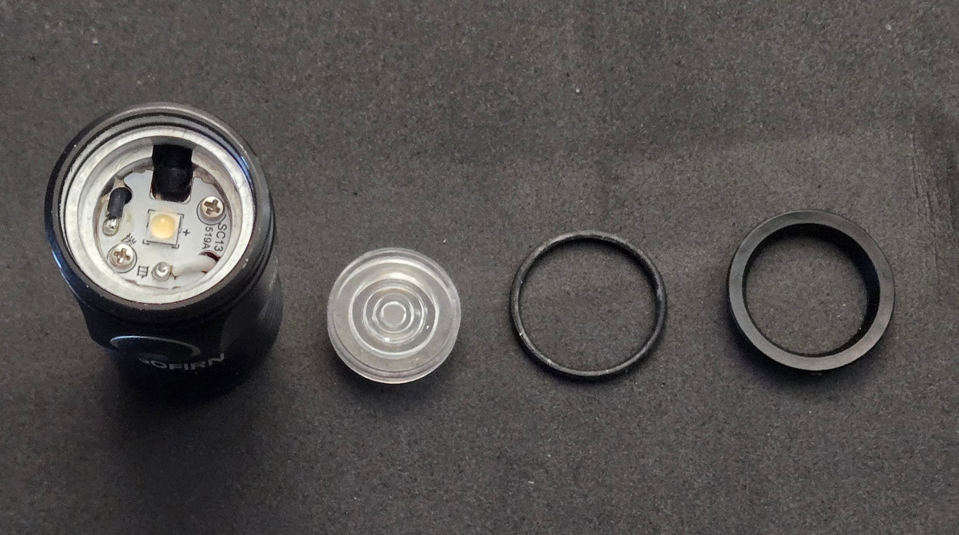

I got it! No scuffs. Took a while though.
I started with razor blades and my mini hammer.
Once the razor blade was bottoming out on the bezel, I added a second razor, stacking both of them.
Once those bottomed out, I switched to the chisel I made.
Now to decide which emitter to put into it.

I decided to knock the dome off this 519a 5000k before going any deeper, and that got me exactly what I needed out of this mod.
