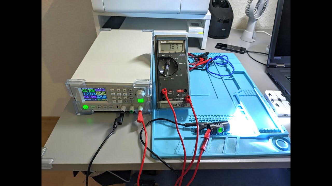

With the Sofirn SC31 PRO flash-light off and the LEDs in the switch turned off too there is a parasitic current of 0,04 mA and regular peaks of 0.23 mA.
See
Is that normal?
Sounds normal to me. The microcontroller wakes up several times per second (and even in power save mode needs some current) and the ADC measurements for low voltage protection need more power (IIRC that’s done once per second).
