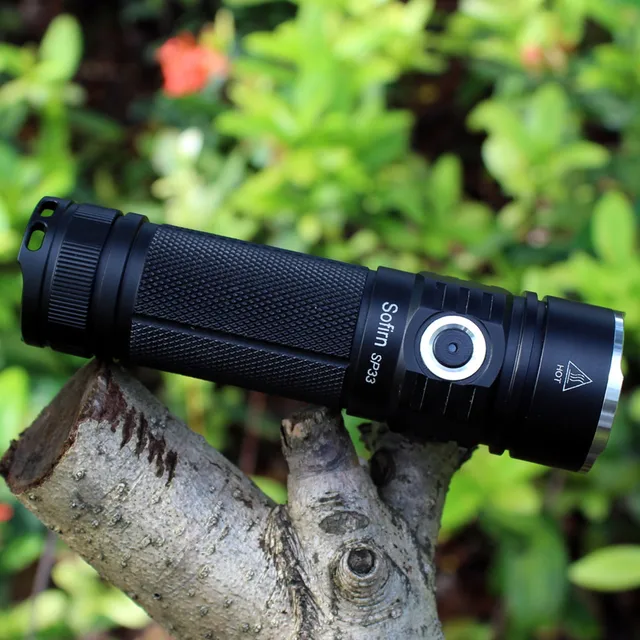

People like either one of these for tube knurling it seems. The Q8 version or the SP33 version.
Most don’t care for the ‘flats’ it appears & most would like some type groove if possible.

Kawiboy, i like your light with the head in the middle (S70s), with the smooth SS bezel (without crenelations, preferably Foybezeled ™), and the tube of the L6 on the Left, (and the sleeker tailcap) but it should not have the cutouts on the finning, (just round fins)
The tube in the middle with the rings are nice as well, but it should not have the ‘flats’
And and extra smooth ring, so you can choose whether to use the tactical ring or not.
