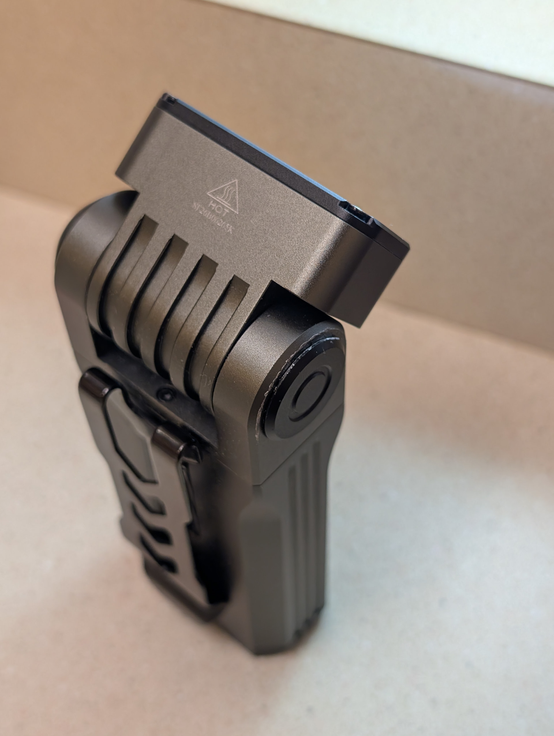

A couple days after I bought a Sofirn ST2, I realized that the hinge had stopped ratcheting and turned loosely.
This was after a weekend of rotating the light back and forth (as one does when fidgeting).
Unfortunately, this meant the head could no longer securely stay at the angle it was turned to.

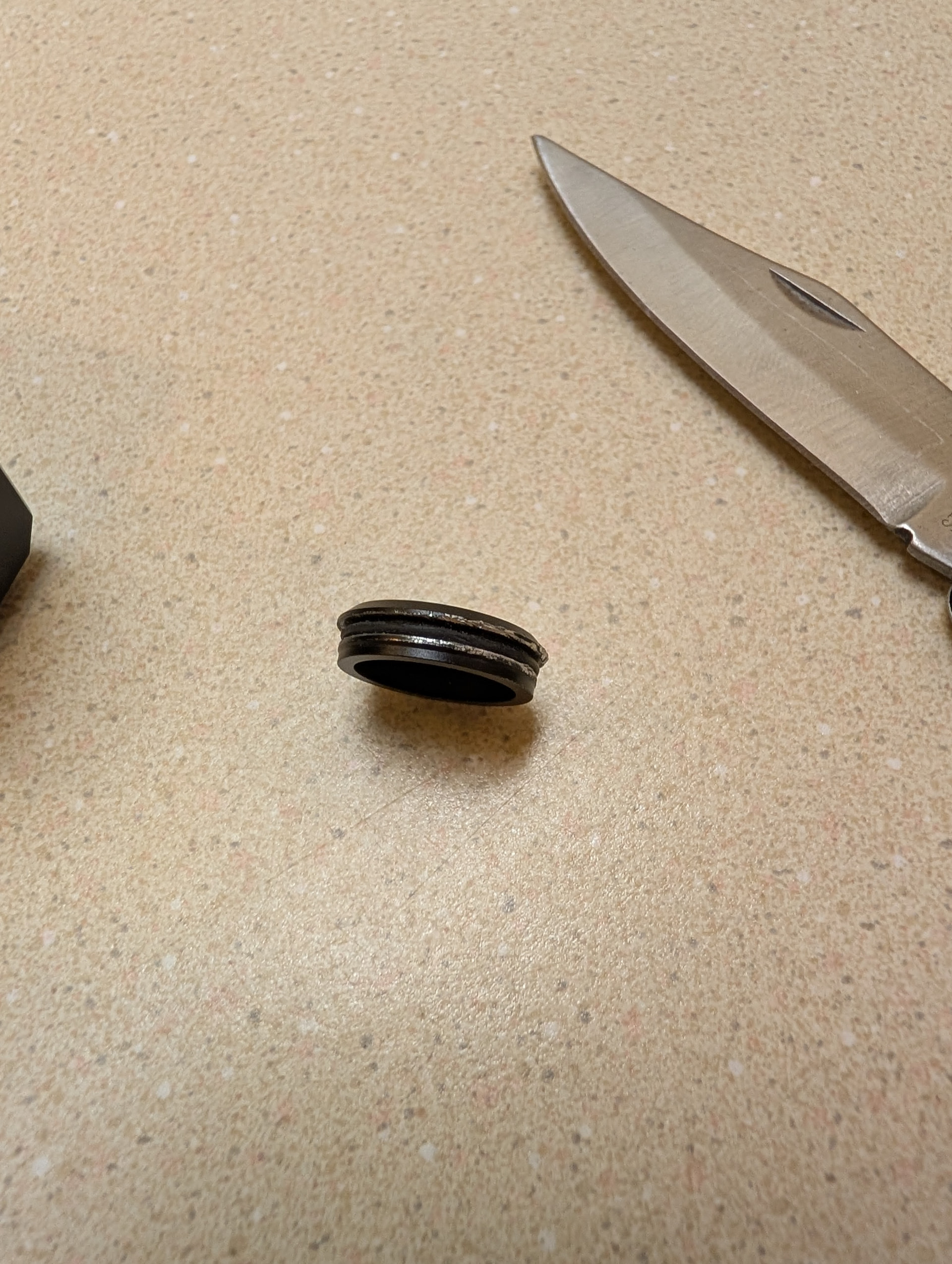

I ultimately succeeded by wiggling a cheap pocketknife into the gap between the cover and the light, prying upwards, and then working my way around the edge until the entire cover was free:
This really scuffed the aluminum, and nicked the o-ring slightly. Most of the resistance seemed to be from the o-ring which sat tightly in a groove - so at least it should have good water resistance.

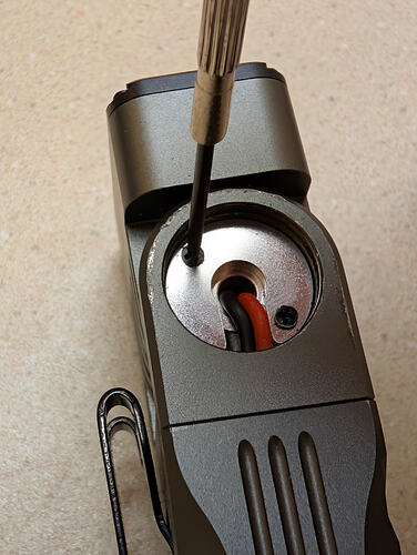

The fix was easy: the screws holding the ratcheting mechanism down had come loose, likely due to the repeated vibrations.
All they needed was to be tightened up! But not too tight, since that actually makes the mechanism a bit stiff.
After squeezing the cover back on, the hinge felt as good as new!
