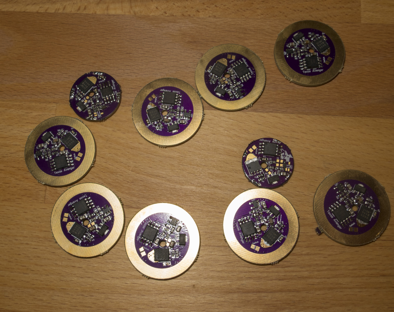

some more drivers reflowed
flashing, calibrating and testing in progress

getting close to have used most parts for the planned 100 drivers
The source for my AMCs seems to have changed supply
I can build some more with PSMN3R0-30YLDX FET
