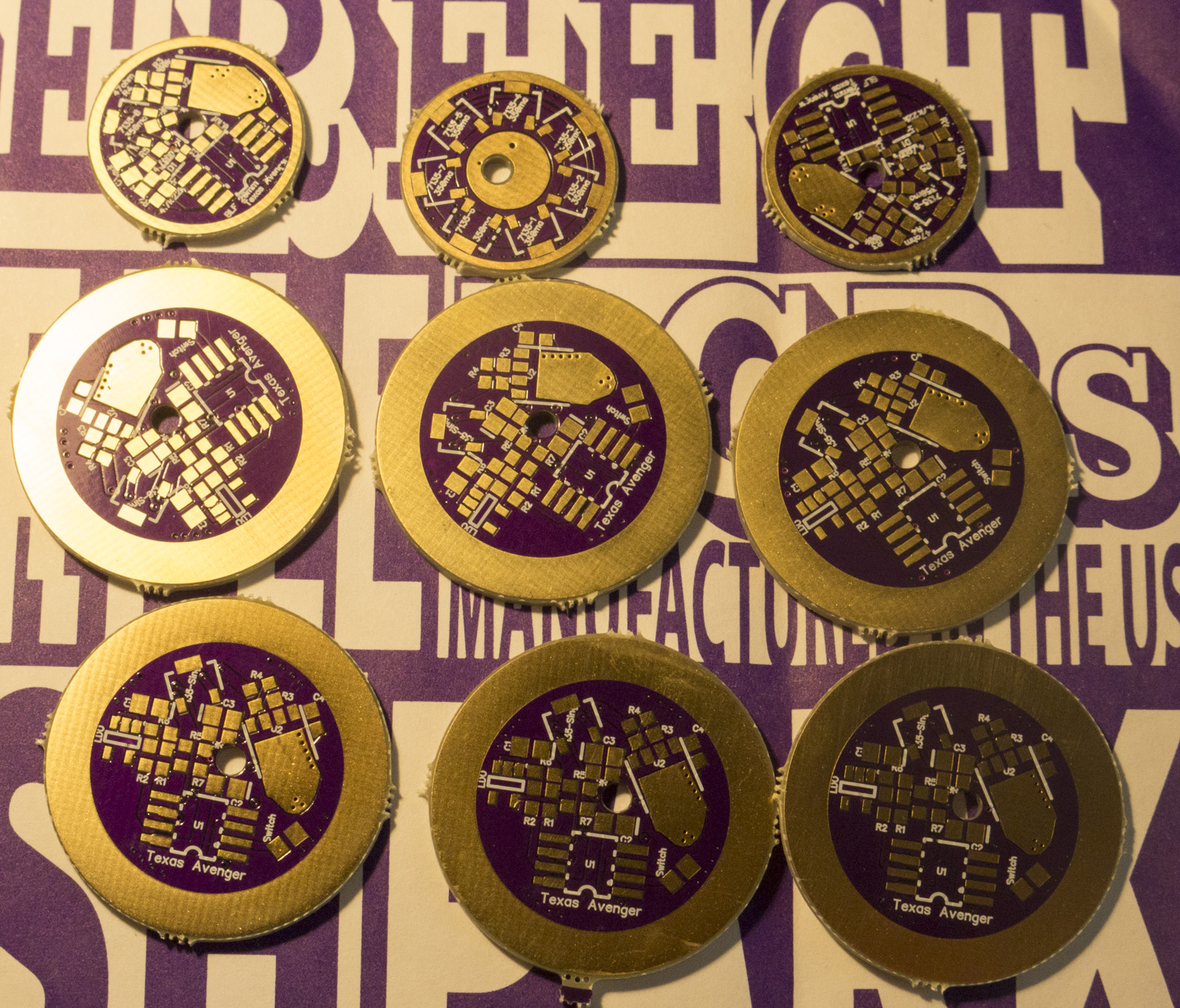

MF01 waiting list
when 3 are requested I order again 3 boards from oshpark
1x mizou51
1x leroycp
new work for this weekend 7 drivers to build

MF01 waiting list
1x mizou51
1x leroycp
1x g_sintornillos
ok we got the 2. 3 for MF01
shipping worldwide is 2$ with german post priority air mail
tracking plus 25€ insurance adds 3$

list updated
just realizes that 6 30mm Narsil boards are here now, but the Attiny85 should arrive next week :person_facepalming: ,
only one board reflowed the other 5 with parts on em just no MCU

MF01 waiting list
1x chooma
1x JIGHEADWORM
