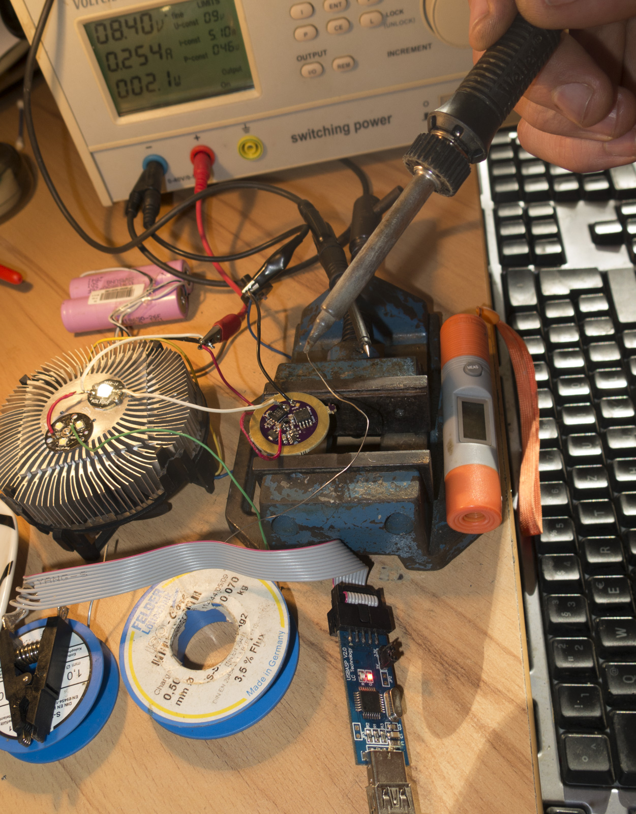

doing the last drivers of this batch programming, testing and calibrating today
also upgraded my testing gear a bit
XHP50 High CRI now for 2S
Heatsink upgraded now has fan running when I turn the switch on
the tip with ground is my switch emulation
