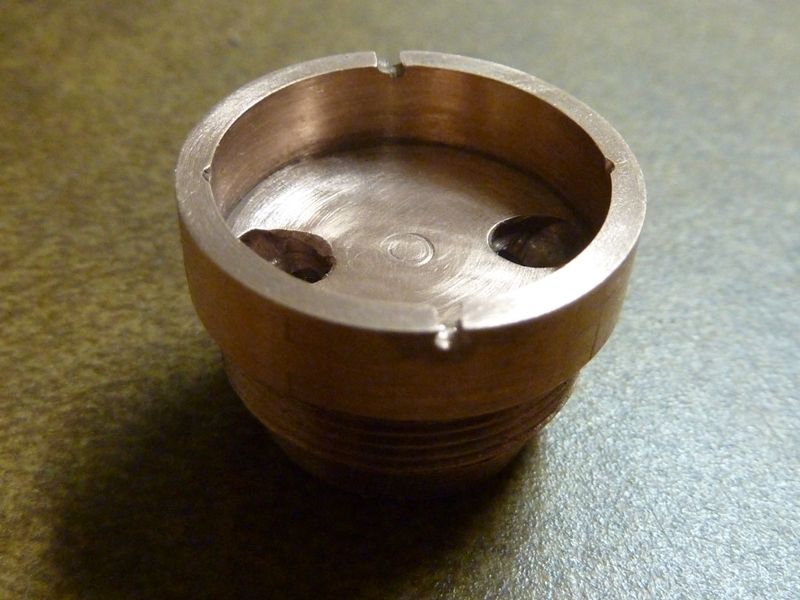

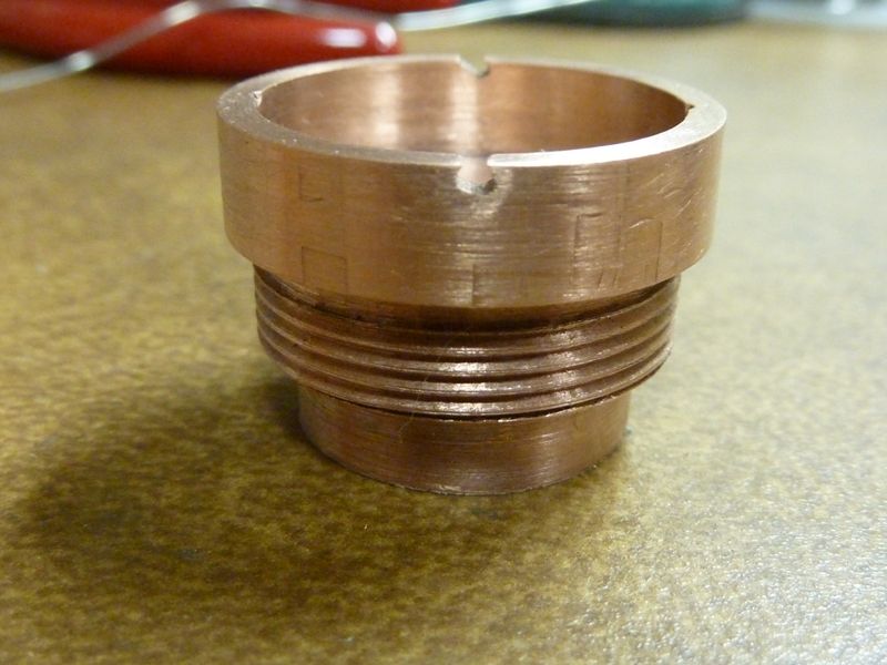

Ok, got them pretty shiny w/vinegar, salt, and lime juice (had no lemon), but I don't care about the shine anymore, here's some pics:

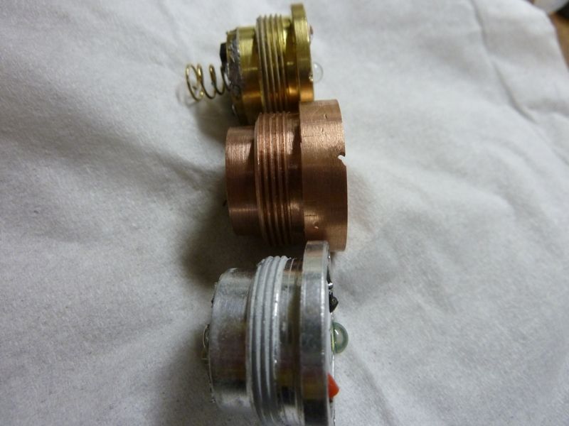

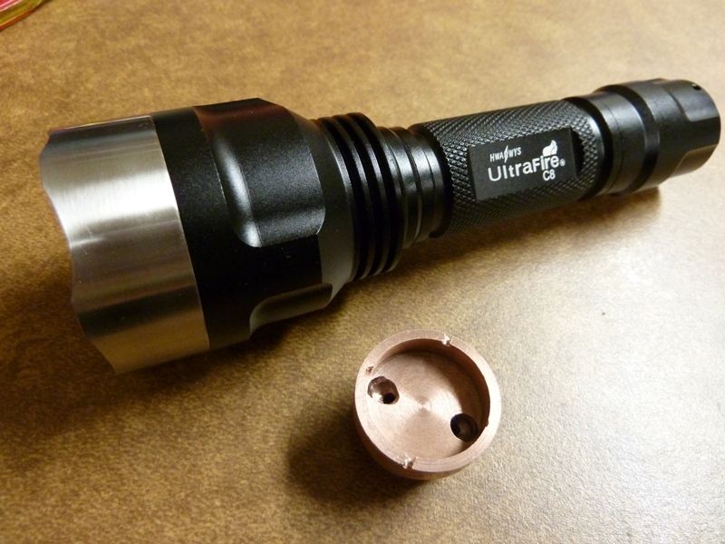

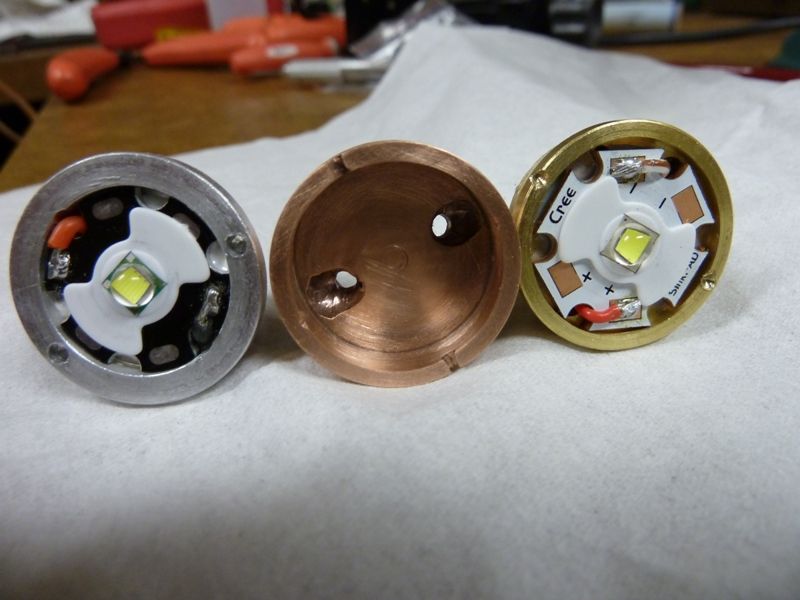

Ok, these not only fit this C8, it's made for it, I mean perfect, no play'n around, nothing, perfect height for the emitter, perfect seating and height for the driver, I mean perfect... What I really, really like about these pills:
- high rim over the LED: don't worry about sitting the pill LED down, the LED doesn't stick out so won't hit anything
- the depth for the driver - for Nanjg's the depth is perfect, winds up being flush with the lip so easiest thing in the world to solder
- I eyeball'ed the dimensions with the original C8 pill and like I said, perfect. Those brass C8 pills from FastTech required some work to get them setup right

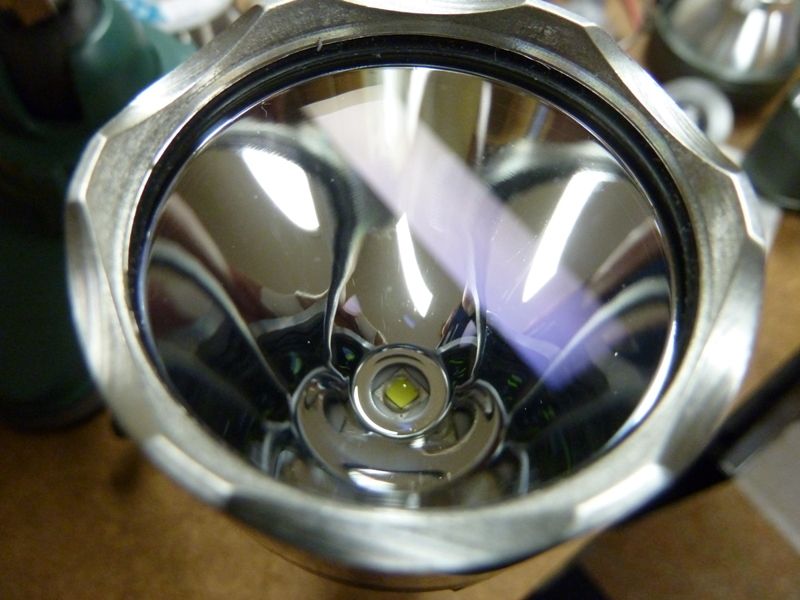

LightMalls C8 U2 version, SS bezel (from a TMART C8), UCL lens, XM-L2 U2 1C/SinkPAD, AS5, 22 gauge teflon coated silver tinned wire, tailcap spring wired, Nyogel treated threads, 3.85A configured Nanjg, custom programmed w/6 modes: Hi/32%/6%/moonlight/intense strobe/battery check-beacon (luxdrv 0.30 - Dr Jones)
Measurements
On a fresh Samsung INR 20R: 3.91A measured:
lumens - 1258 at start, 1230 at 30 secs
throw - 47 kcd, 433 meters 49 kcd, 442 meters (loosened the pill - from pics, saw the emitter is set a little low, ok - maybe slightly less than perfect but can fix that)
Beauty.
My result at 3.76 amps on alloy star was 36,480 lux, same led (xml2 U2 1c)
So looks like around 30% gain total which is about right :slight_smile:
