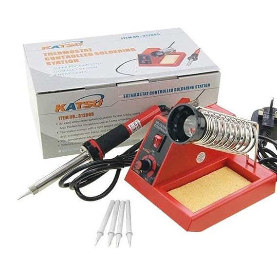

I am now thinking of this simple unit for about £20:
https://www.amazon.co.uk/Draper-61478-40W-Soldering-Station/dp/B010823P38
or this, which may be the same thing
https://www.amazon.co.uk/Variable-Temperature-Soldering-Station-Electronic/dp/B01F5OIWHS

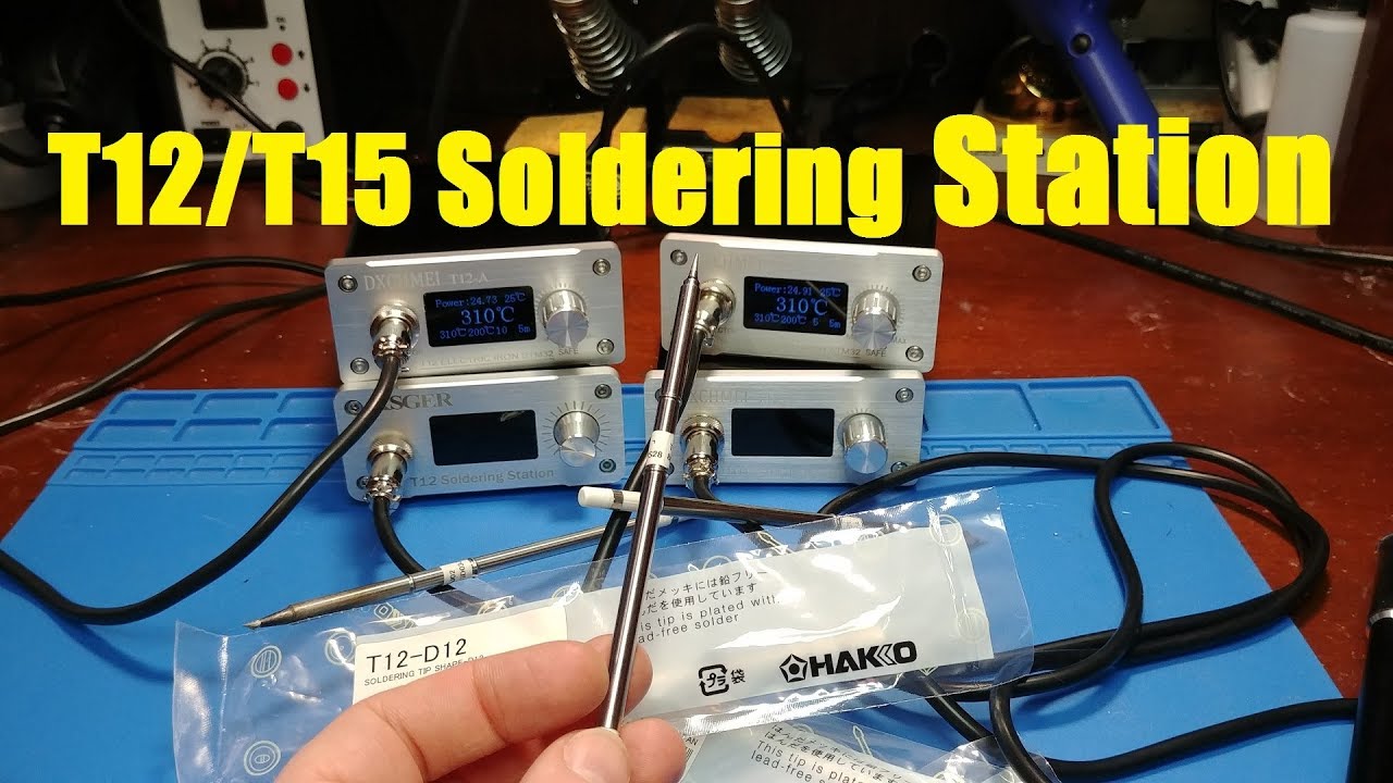

I’ve watched a few youtube reviews of the clone T12 stations.
This video reviews the KSGER and DXCHMEI.

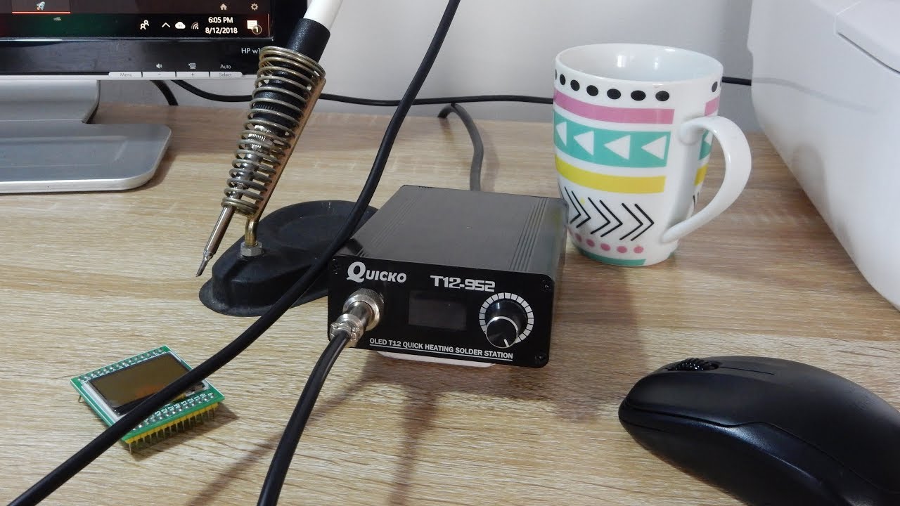

And here is a review for a Quicko

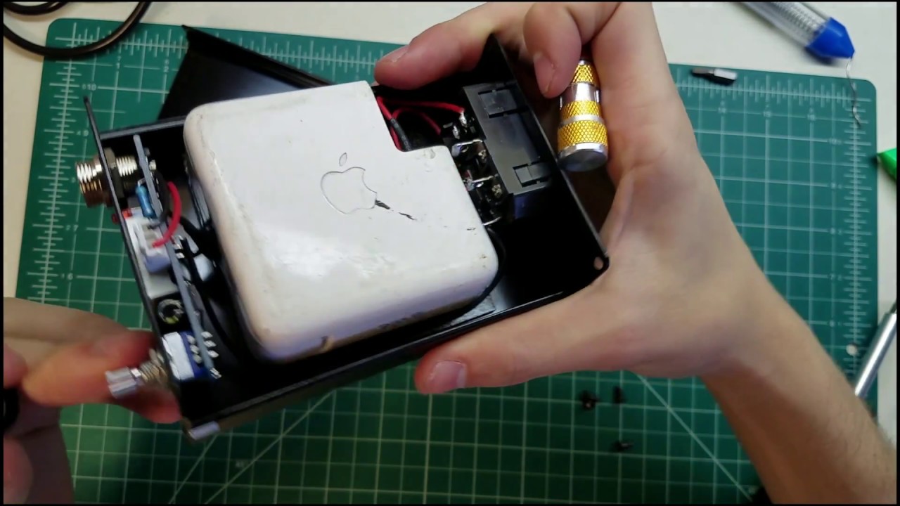

I also saw this, where the power supply inside the case is an old Apple power brick…
I’ve also noticed the handles for the KSGER has 5-pins, and the Quicko have 4-pins. What’s the difference? Which is better?
So far, based on reviews, Quicko may be what I want to get.
Thankfully I ordered a KSGER with the stock handle from Amazon. If it’s as buggy as the reviewer claimed, I’ll return it.
I could be wrong but I believe some of the KSGER units may have an accelerometer in the wand to allow it to signal auto-off if the wand is sitting in a stand. The pages I saw weren’t very clear but that is what they seemed to be suggesting so that might be why it has a 5th pin.
Seems the KSGER unit isn’t all that great and seeing how the tips insert into the wand, it seems the Hakko is superior for quickly changing tips.
I use KSGER soldering iron with real Hakko T12 tip (JL02, bent, sharp) to soldering almost all my small project including Gxb172 driver, so I can say it works very well.

I ordered a Quicko 942 T12 station from Aliexpress (still in transit) that takes the external power supply. I hear the internal supplies are dodgy and unreliable. You can use a 19.5V 4.5A (90W) laptop power supply that is much higher quality and reliable. The controller users a 5.5x2.1mm connector so your power supply needs one one of those.
