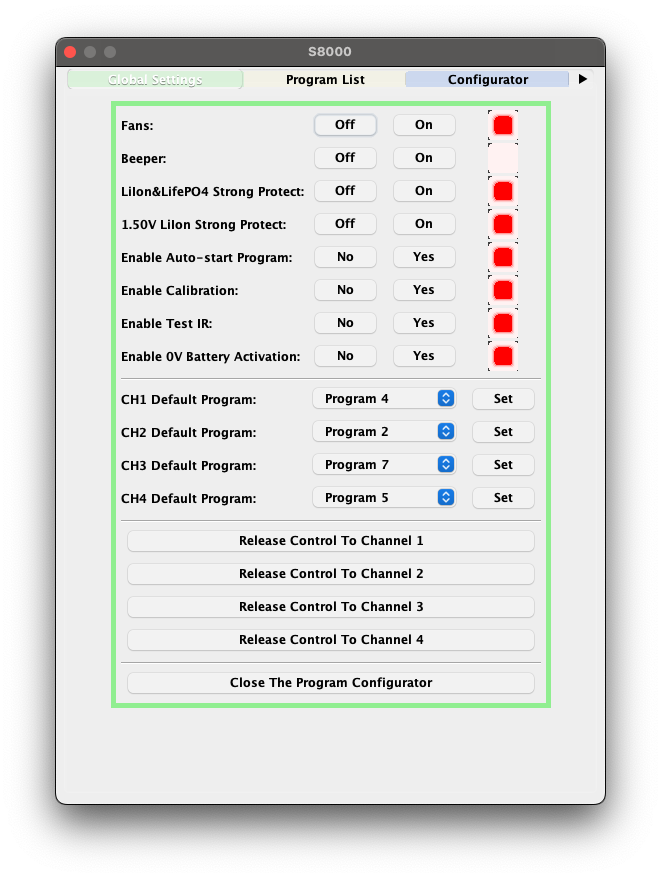

Part of configuration menu for it (It is dynamic and will include more fields when selecting a cycle function):
The extra functions, it is easy to copy all settings to another charger or do a printout of the programs or generate templates for TC scripts:

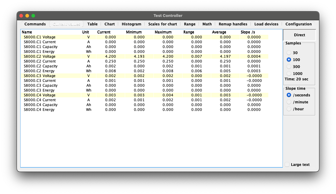

I’ve got TestController running on a Mac Mini.
Install openjdk8
brew tap adoptopenjdk/openjdk
brew install --cask adoptopenjdk8
Download TestController from Test Controller introduction
unzip TestController.zip -d TestController
Download the latest definition for S8000 from Enova and put it under TestController/Devices
Connect the Gyrfalcon S8000 via USB-C to USB-A to micro-USB.
ls /dev/tty.*
In my case, the device is /dev/tty.usbserial-2120
Run TestController
cd TestController
chmod +x tcrun
./tcrun

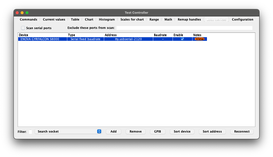

Go to the Load Devices tab.
Add the S8000.
Click Reconnect and go to the Commands tab.
This is what the Current Values tab looks like while charing a cell in CH2.
Commands > Setup > Global Settings

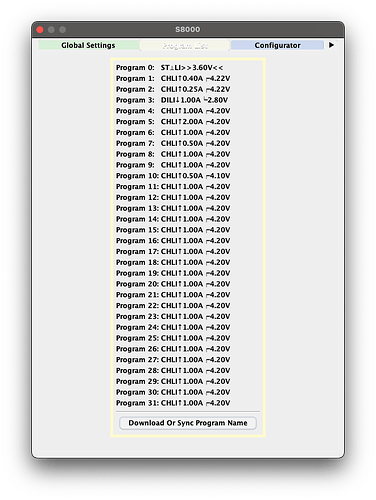

Commands > Setup > Program List
