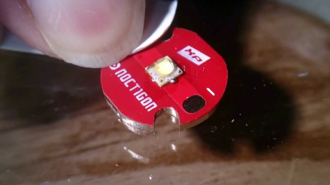

I had a 219 leftover from the DIY-built contest this summer that had lost the minus solder pad. However there was a small shred going to the inside of the led still hanging about so I reckoned that if I reflowed it, the solder would adhere to that bit and the led should work. So it was a fine led to try dedoming it. I did it with a scalpel while the board was still hot from the reflow (on youtube it is in HD):
So that worked well, no phosfor left on the dome at all. The feel was different from Cree leds though, the Cree silicone is more flexible, gives way and comes off slowly, this dome just snapped off, feeling a lot stiffer. this was the result:
