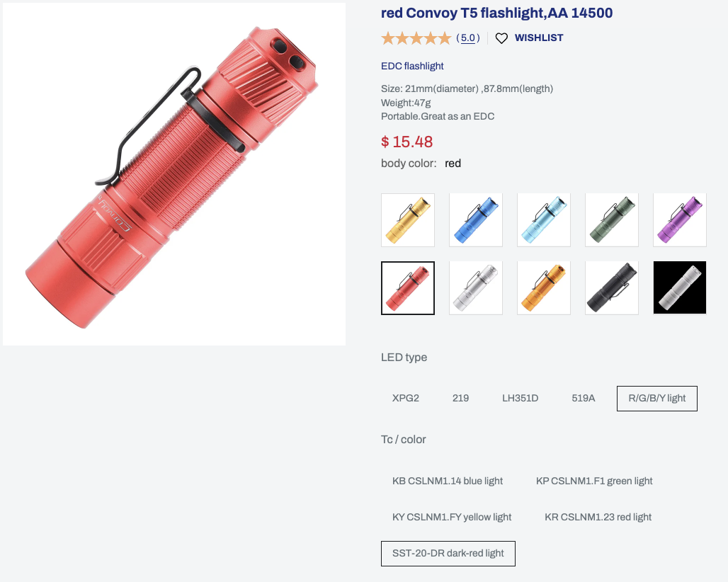

you can get a Convoy T5 w 660nm red for under $20

ahhh, thanks for that. I already have the T3 coming. I also have a wurkkos hd50 headlamp - both with sst20 660 leds. I shall try to find a lamp with sst20 660 leds then because of the 21700 battery - on low it should last for a few weeks use (an hour a night or so) between charges

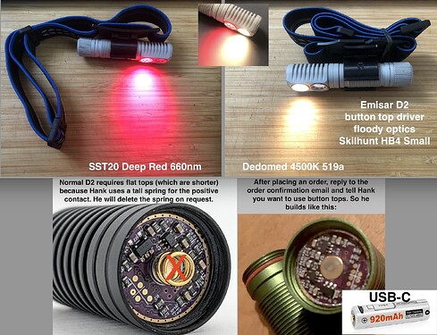

this is my red plus white headlamp option, Emisar D2 w USB-C Battery:
it looks an awesome light. I like the sst20 leds - they seem to have high output for a tiny amount of energy input.
