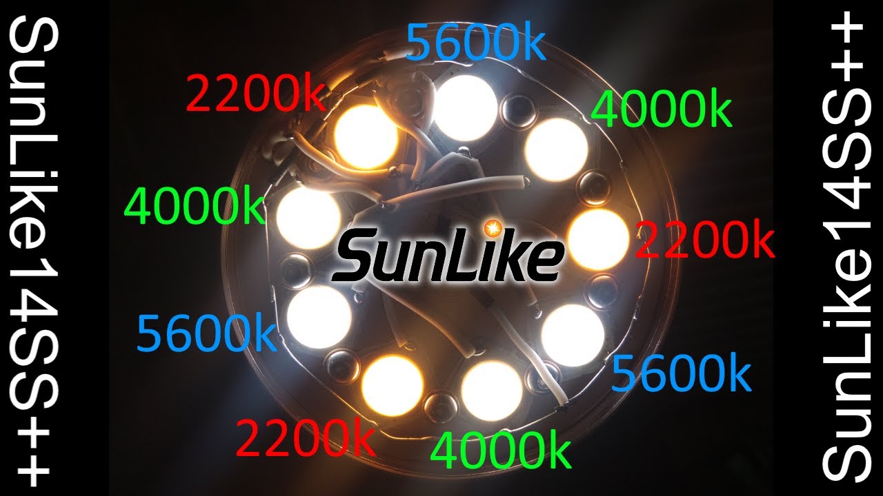

14-3030 december 2019 100x86.6mm (idea was to change CCT and do not use additional heatsink)
