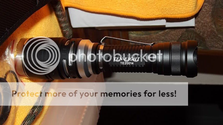

Shadowww, All of my units look like yours with out the dents.
Thanks raccoon city! Thats an awesome light you have! :bigsmile:
-Shane
It is a very nice flashlight.
Unfortunately it belongs to BLF member rikr, and not me. :(
(Don't worry, I'll live.) :)
