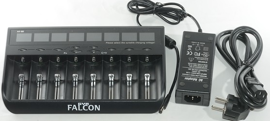

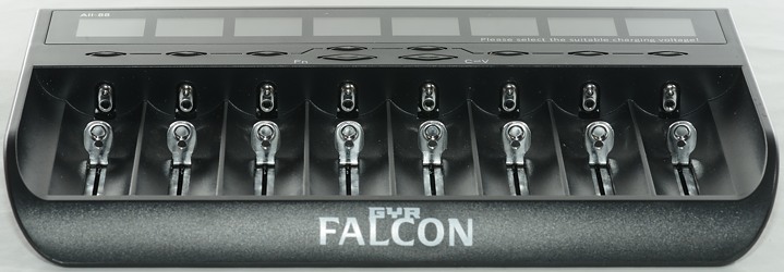

Enova makes many different chargers, some time ago I tested many of them, include a 8 slot charger. This charger here is a completely new design that is a much more versatile charger. It can charge most types of round cells on the market. The reviewed version is a pre-release version.

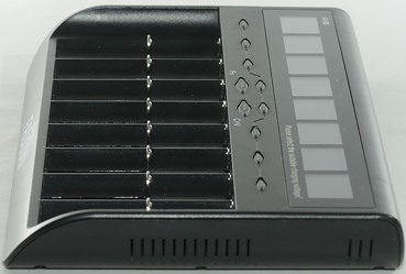

The charger uses a very flat design, it is only 32mm high.

Because I got the charger and a power supply a bit before the release date, there was no manual included.

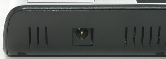

The DC input is the usual barrel connector and it is rated for both 12V and 24V input, making it possible to use the charger in a car.

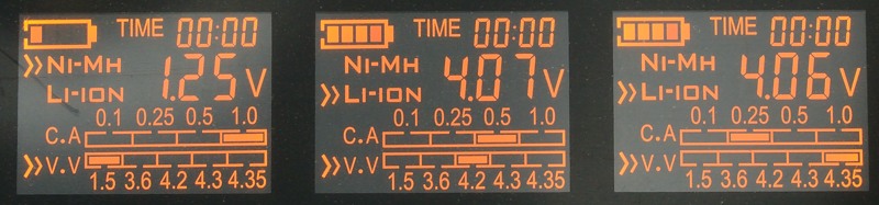

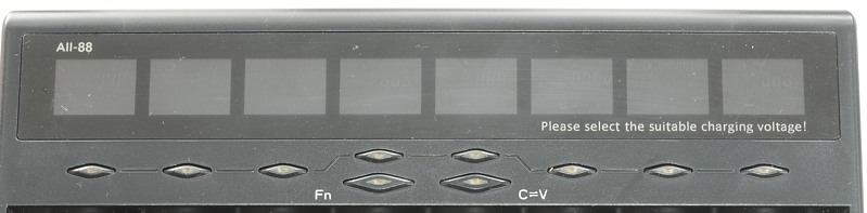

The display has many elements on it, because the charger can handle many types of cells.

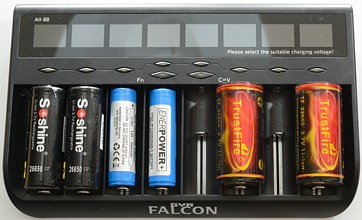

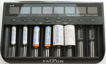

Here the charger is working with 3 different cell, each with its own setting.
The C.A line shows selected current and is also used to select current when the “>>” marking is at this line.
The V.V line shows selected charge voltage and is also used to the select voltage when the “>>” marker is flashing at this line.
The battery icon is animated when the charger is charging.
The display will automatic dim after some time, any button press will bring it back to full brightness.

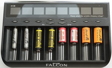

The full user interface with 8 readouts and 10 buttons, one for each slot and two special buttons. All buttons has a leds in them.
The slot buttons will show a green (blue in release model) led while charging and a red led when done.

Due to the long display the brightness is not uniform in the display.

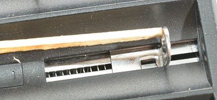

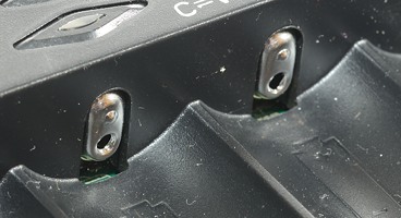

The sliders work very smooth and can handle from 30.0mm to 71.2mm, up to ø26mm cells can be placed in each slot and it is possible to use ø32mm cells in each other slot if they have a large top (i.e. LiIon will usual work, but not NiMH D cells).
Due to the wide slots, care has to be taken with thinner batteries to get a connection.
The charger can handle 71 mm long batteries including flat top cells.
With 10180 cell the 100mA charge current is on the high side, but because most 10180 are high current cell it will usual be acceptable.
C cells has a tendency to slide of the plus connection.

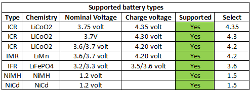

Charging 4.20V LiIon cells

The charger supports both 4.30V and 4.35V cells, I only did a test with 4.35V and it looks fine.
The way the tolerances (+/-0.05 volt) falls on this slots, means it could charge both 4.30V and 4.35V cells on the 4.35V setting (On slot \#3 that would not be acceptable).
Charging 3.6V LiFePO4 cells
%20%231.png)
%20%231.png)
%20%231.png)
The charger works perfectly with LiFePO4 cells.
