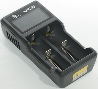

Charger Xtar VC2
Xtar makes many LiIon chargers, this is a usb powered dual channel charger with display. The charger can charge with up to 0.5A for each channel, but the current is not user adjustable.

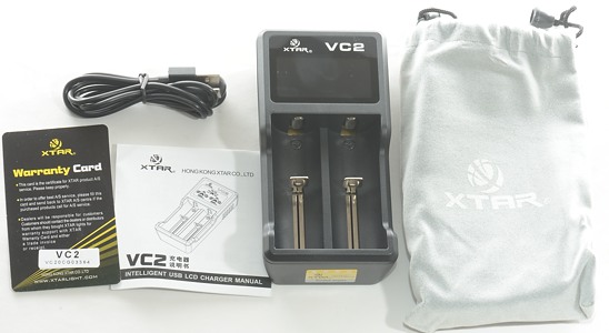

I got the charger in a small cardboard box with the specifications printed on it.
Inside the box the charger was in a small fabric bag, this can be useful if it is used as a travel charger.
The bag contained the charger, a usb cable, a warranty card and a instruction manual.

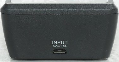

The charger is usb powered from a micro usb connector, but there is not a power supply included, i.e. you must supply your own usb power supply/charger. With a maximum charger current of 1A the charger works best with high power chargers, but will reduce its current if the power supply is overloaded.

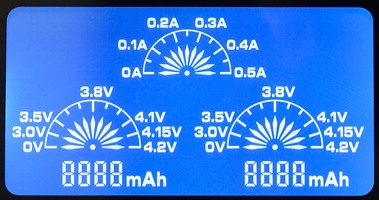

There is only a display as user interface, no buttons or switches.

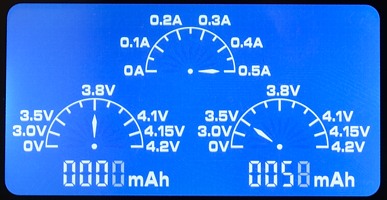

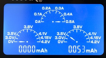

The display uses dials to show voltage and maximum current, it does also have some 7 segment digits to show charged capacity.
The current dial only shows the maximum charge current, the actual current is lower when the battery is in the CV phase.
The voltage dials shows the actual voltage when in range:
0V Battery voltage is low, charger is only using low current, display may show "Err" if there is a problem with the batteries.
3.0V Voltage is high enough to start regular charge.
3.5V-4.2V Regular charge, display is within 0.1 volt.

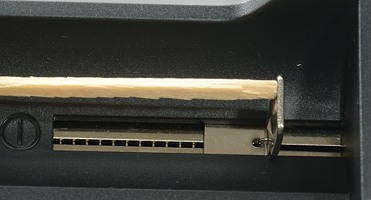

The charger can handle both button top and flat top batteries.
The slider moves smoothly and can hand cells from 30mm to 71 mm long.
The charger can handle 71 mm long batteries, including flat top cells.
