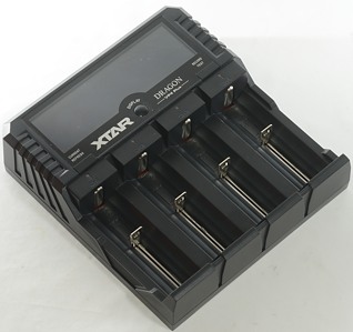

Xtar has many good LiIon chargers, this is the new top of line model. It can charge 4 round cell, a 3S battery pack and a smartphone, it can also measure capacity, or work as a power bank and it has a cell resistance and voltage meter.

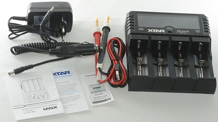

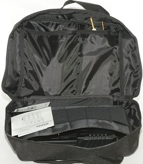

It comes in a cardboard box (I got the charger without a box and the pictures is supplied by Xtar).
In the box is a bag that contains the charger and accessories, there is also an elastic strip to hold batteries.

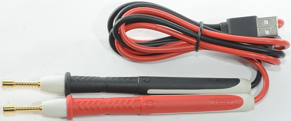

The contents of the bag is the charger, a power supply, the resistance (IR)/voltage probes, car charger, instruction sheet, welcome note and warranty card.
The probes are four terminal and uses a usb connector. The 4 terminal connection means that it will automatic compensate for any wire resistance and connection resistance at the charger, but it cannot compensate for connection resistance at the battery with the supplied probes.
The probes are spring loaded and has a rough surface to get better connection.

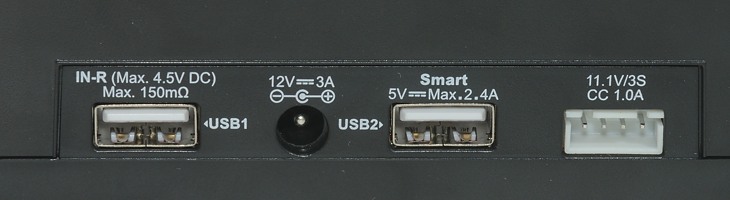

The charger has a DC connector for power input, two usb connectors, one for the IR probes and one for power output. There is also a JST-XH connector to charge a 3S LiIon battery pack. Because the charger is “only” charging at 1A this function do not need the main connection to the battery pack.

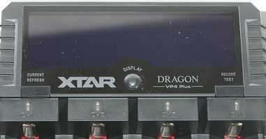

The charger has a large screen, four leds and 3 buttons:
Current/Refresh button: A short press will change current setting, a long press will start a refresh cycle.
Display: A short press will change between displayed slots (With 1 or 2 batteries the display will always show the correct slots), a long press will set the display to lowest brightness, a double click will return to main screen.
Record/Test: A short press will recall test data (The result of test runs is automatically saved), a long press will start a test cycle, a double click will turn sound on/off.
When showing recorded data the buttons has functions to step between records and delete records.
When display brightness is reduced the first keypress will restore it to full brightness.

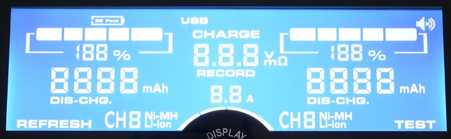

Here is the full display captured during power on.

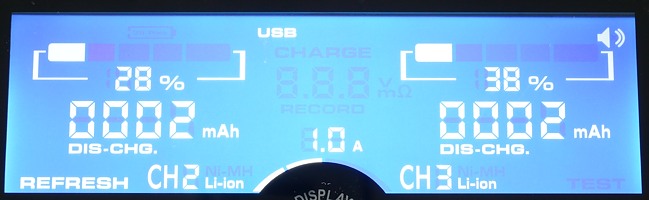

Discharge during refresh mode, the blocks are animated to show that the charger is discharging.

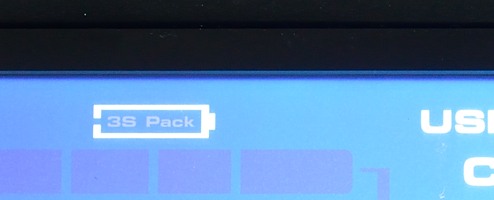

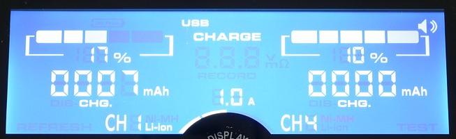

The 3S charging do not have much display space, only one icon, flashing while charging and steady when done.

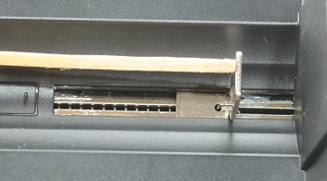

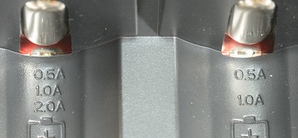

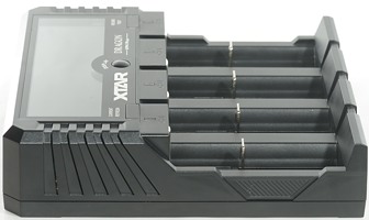

The charger uses the typical construction with a slider, this time with a very long connection at the plus pole making it possible to handle D and 32650 cells. The slots can handle from 30.5mm to 72.8mm.

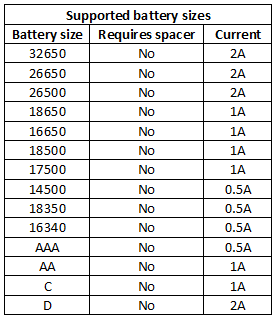

The charger can handle 70 mm long batteries, inclusive flat top cells.

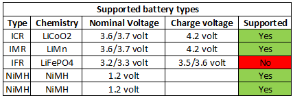

Above 2V the charger assumes LiIon

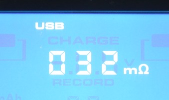

To start IR measurement the probes must be shorted, to leave IR mode double click the display button, the charger will also leave IR mode after about 10 minutes.
Due to the way the measurements are done the charger can only measure batteries, not resistors.
The above values is with LiIon cells, the result is a little bit on the low side, but very consistent.

Charging 3S pack, I do not really know how useful this is, there exist many pack sizes (2S, 3S, 4S, 5S, etc.). I would have liked an output to charge a 2S bicycle pack.
Internal resistance/voltmeter, this is with separate probes. This gives very consistent results when measuring IR, much better than the typical in slot measurement on some chargers, the voltmeter is also good.
