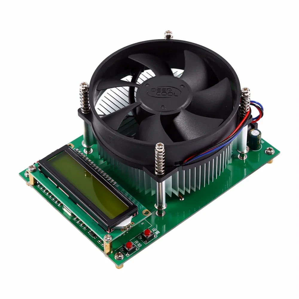

Electronic load 60W
Official specifications:
Board size: 100mm x 70mm x 57mm (fan prominent board about 12mm)
Positioning hole location: 60mm x 88mm , hole diameter is 3.2mm 5mm pedestal installation
Working Power requirements: DC12V
Operating mode: Single-mode constant current (CC)
Discharge current: 0.20-9.99A stepper 0.1A or 0.01A
Discharge current maximum error: 0.7% –0.01A
Maximum capacity test error: 0.5A 2.5, 2A 1.5, 5A and above 1.2%
Offline (termination) Voltage Range: 1.0-25.0V stepping 1V or 0.1V
Discharge voltage: 1.00-30.00V
Maximum voltage measurement error: 1% + - 0.02V
Maximum power: 60W super power automatically limit the maximum current
(for example, up to 60W when it can start 9.99A 6V and 20V maximum can only be opened at 3.00A)
Highest battery test statistic: 999.9Ah or 9999Wh, reaches the value stop testing (in value by a first stop condition)
Fan control: intelligent fan control (fan can automatically according to the heat sink temperature infinitely variable)
I bought it from banggood.com
It arrived in an envelope without any documentation or accessories.
I checked the connector (BUS) with a scope: Vc: 12V, F: 50Khz at 5V, L, T, G: 0V, R: 5V. R and T is probably a 5 volt serial bus, but it is not sending data by itself.
The two green leds between the display shows what digit the encoder is adjusting on.
There is some chips hidden under the display.
The encoder can both be rotated and pushed. Pushes are used to move between the four settings (0.1A, 0.01A, 1V, 0.1V)
Here is the display from ready mode, when running the “u” will be replaced with one more voltage digit.
At the current time the encoder will adjust 0.1A setting, this is based on the two green leds.
