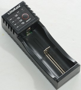

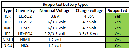

LiitoKala has made a couple of analyzing charger, but this model cannot do any analyzing, it is a small universal charger that handles 3 types of LiIon and NiMH, it addition to this it can also work as a power bank.

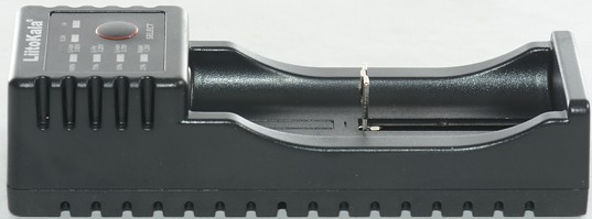

The charger is powered from micro usb and has a full size usb connector for power bank output.
The charger has two red leds to show selected current and four blue leds in a row to select voltage and show battery level.
The button has multiple functions:
When a battery is put into a powered charger, it can be used to select LiIon voltage (NiMH is selected automatic).
When charger is powered a long press (2 seconds) will change between 0.5A and 1A charge current.
A fast click when charging will show the selected battery type.
When used as a power bank a press on the button will turn the usb power on.

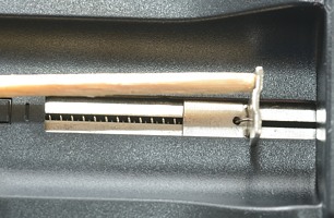

The charger uses the typical slider construction, it can handle batteries from 33mm to 70mm.
The charger can handle 70mm long batteries, inclusive flat top cells, this means most protected cells.
