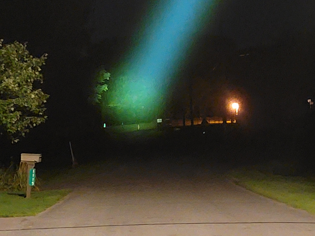

Olight odin turbo arrived yesterday.
At first I was turned off by the mount base that is permanently part of the handle. After a few hours of use I started to like that. You can avoid it or use for grip. They could have dehorned it a bit…edges are not sharp, but a little harsh for soft hands.
This is just my second olight, but I don’t get the disdain I see from people. S2 baton is the longest I have ever stuck with a light, and I am quite pleased with this purchase and confident it will be one of my most frequently used.
Other downsides. Proprietary battery (for charging), Samsung 40t is too short. Tail threads are not anodized, so to lock out you have to screw the tail cap off so much it might fall off. Maybe it has electronic lockout. When all else fails, read the instructions.
Not a fan of the UI, but not sure what I would change. I will just use high. Momentary is easier with extended switch.
Pictures and wall hunting the beam looks pretty yellow. To my eye outdoors it is much more neutral. No fog last night, but some fire smoke. I am confident it will cut through fog better than any aspheric I have bought or built.

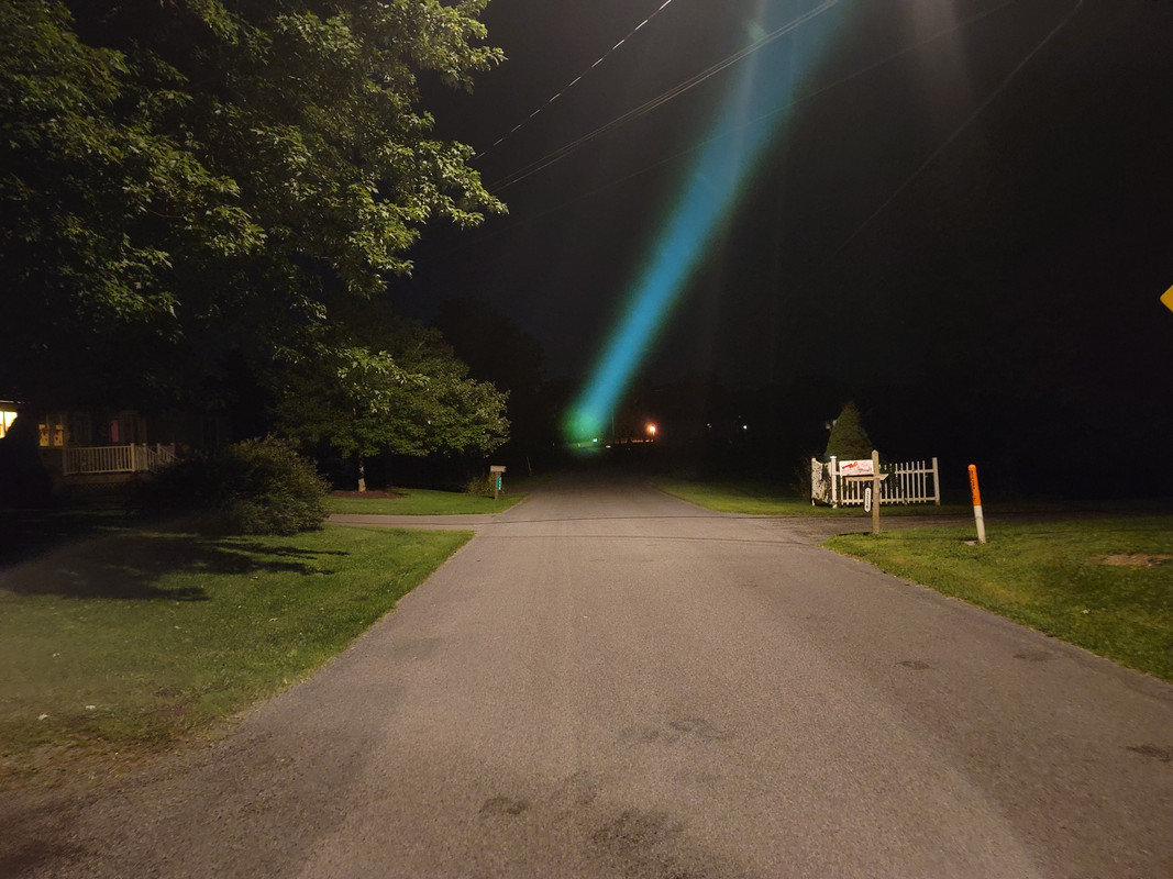

I am glad I bought a small lens LEP. Outside 100m the beam becomes useful to me. Pic is probably 350m,standing under last street light on the street, on purpose, because I find that impressive.
This will work amazing for boating, and come October 1st, the coyotes here will learn the hard way what an LEP is, however briefly.
I had no idea how great LEPs are based on reviews and beamshots. I spent countless hours trying to build lights like this, and this is far superior performance, much smaller, incredible runtime and almost no heat. I hope someone crams one into nightwatch nsx4e.
Optical and digital zoom on my phone, different take.
