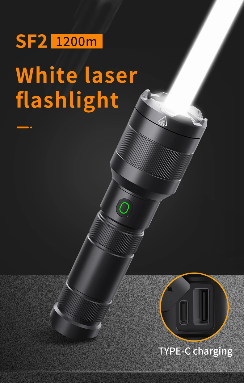

Anybody stumble across this yet? https://www.aliexpress.com/item/1005003814334109.html?
Built in 21700 isn’t my style, nor the power bank functions, but the UI is actually ok with two mode groups… one being single mode - which is what counts in my book.
No, hadn't seen that one before.
I like their use cases!
must be fun meetings!
I don’t like the lack of a cover glass over the projection lens. The projection lens is always plastic in LEPs.
Fair point! I didn't notice that.
btw.. I hadn't seen this *fire name before yet.
Natfire
