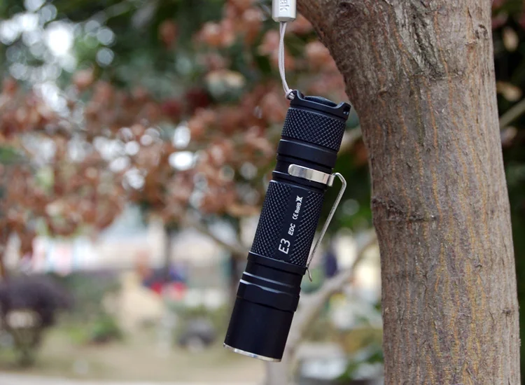

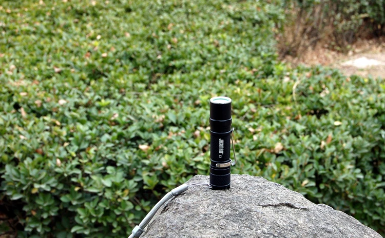

after few months work, now we have finished the improvement of E3 flashlights, now let me introduce some details of the E3 to dear all.

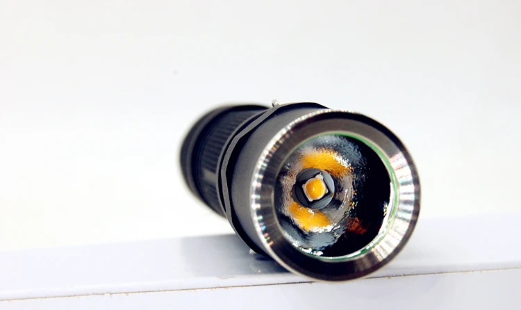

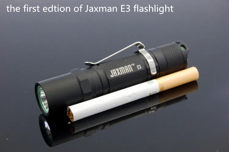

first, according to the 1st edtion of E3, new edition has a stainless head.
second, the new E3 has a bigger head and tail in OD, and a smaller wrist. that will make it a little hansom.
in order to make a stainless head ring design ,I have to choose this whole body solution…… :person_facepalming: which many friends like…
Jaxman ordered DTP MCPCB will be standard design in later products.
the driver can avoid an reverse of battery placing. all small parts are with Au coating.
now the tail cap is more smaller than the old edition,easy to find and press.
and Li Ion batteries are also ok for it……but pls take care of over discharge…

2,use 5050 LED or 3535 LED? I think the reflector is small, if we use a XML SIZE —-flood well; if use xpg2 /nichia 219 size—-have a well spot…

hi, the old E3 is finished no late than Feb 2015. see a picture uploaded in my China store:
If the copy lights is sold not late than Feb 2015,then I can say I make a mistake…
and that all is not important,all is passed, I only hope, they not make a plagiarism of new E3.
3535, so you can use the same reflector for xp-l, xp-g2/3 and nichia 219C
