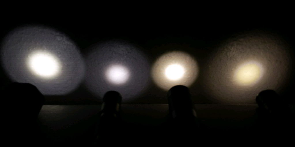

Beamshot, though I don’t feel that it does justice to the Luxeon V2
Left to right: Convoy M1 with 70CRI XP-L 5000K, UltraTac A1 with 90CRI 219B (I thought 4000K but maybe not), Convoy S2 smo with Luxeon V2 70CRI 4000K, Wuben E05 with 90CRI XP-L2 80CRI.

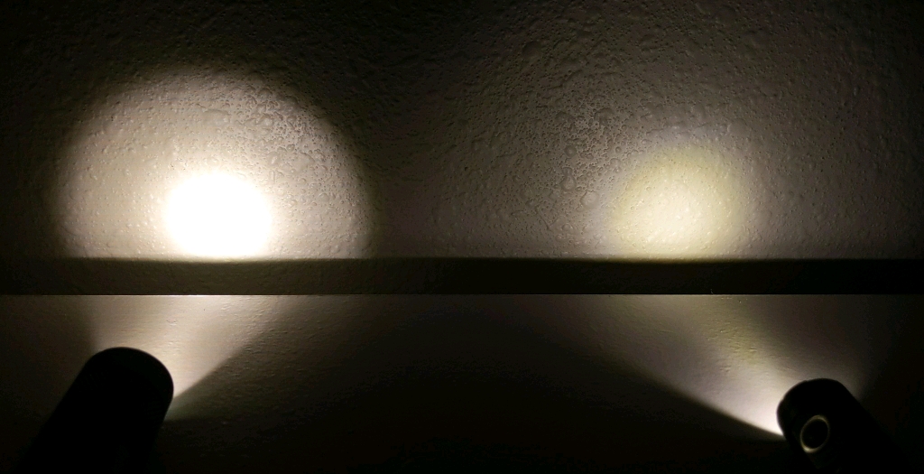

Here’s another between the Luxeon V2 and the XP-L2 4000K 90CRI:

Thanks, I like it also. Not sure about this “Wuben E05 with 90CRI XP-L2 80CRI”
I would be interested in seeing someone test this too.
XP-L2 can work well with a frosted or pebbled TIR though.
