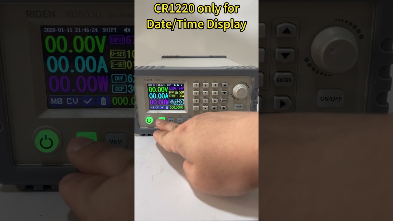

CR1220 battery in RD power supply is not included because most shipping way does not allow pure battery inside, and it is only for date/time display, no other function, without it, RD power supply can work normally

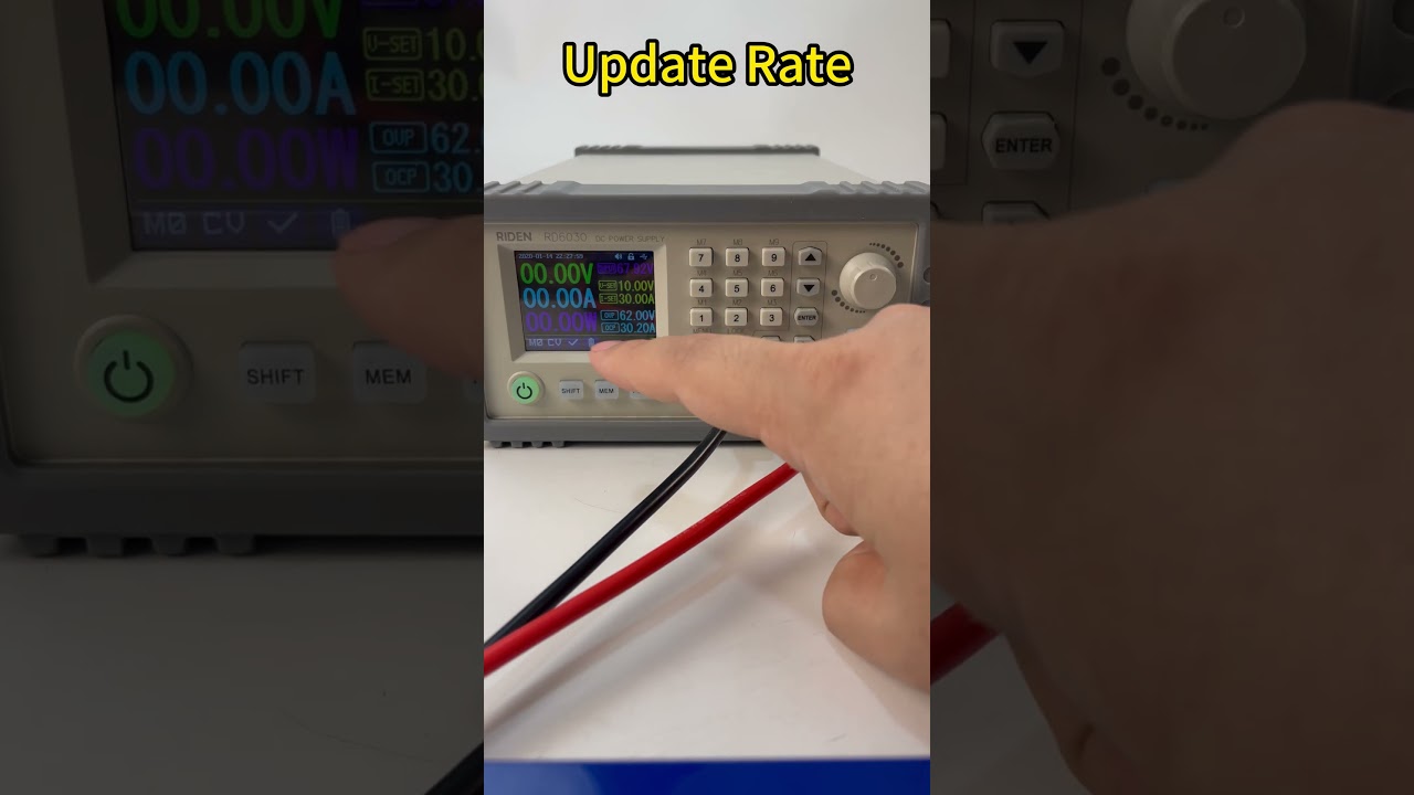

hello, if you find the value changes too slow, you can set the update rate from Slow to High, then the value changes faster, but in this way, output value is floating since the sampling time is shorter, it may be annoying

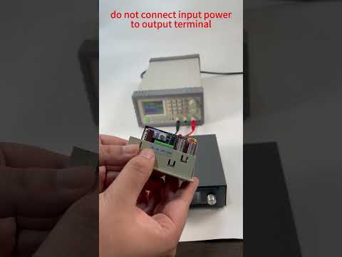

for RD power supply, output on the front and input on the back, but for RK6006 and DPS power supply, the input and output on the same panel, so that some prople may reverse connection, if you find output is 0.5V higher than input, wrong connection

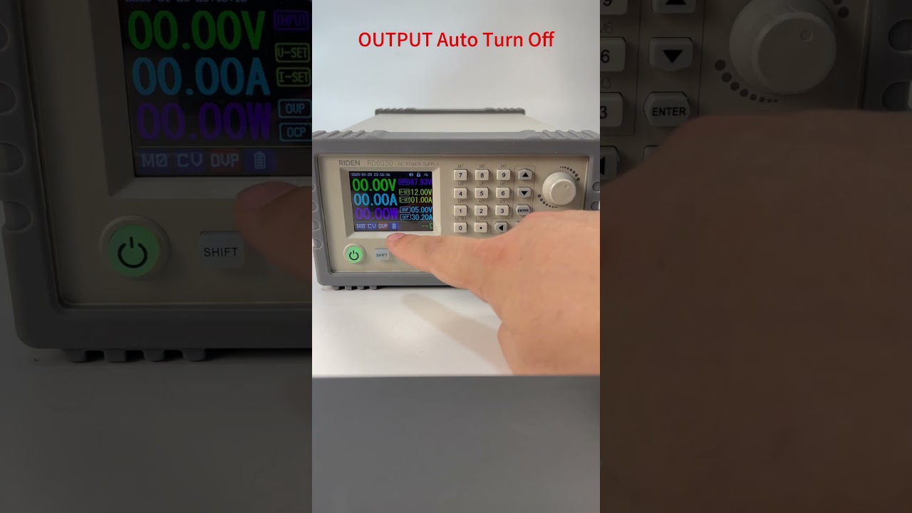

hello, if you turn on the RD output, and it turns off soon, please check:1.if the OVP value lower than output voltage2.if you charge battery, check if setting voltage 10V higher than battery voltage 3.check the cutoff current and Temp you set

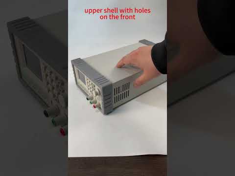

for S800 case, the side with holes needs to be placed on the front to deliver the heat from RD power supply, do not install it in the wrong way

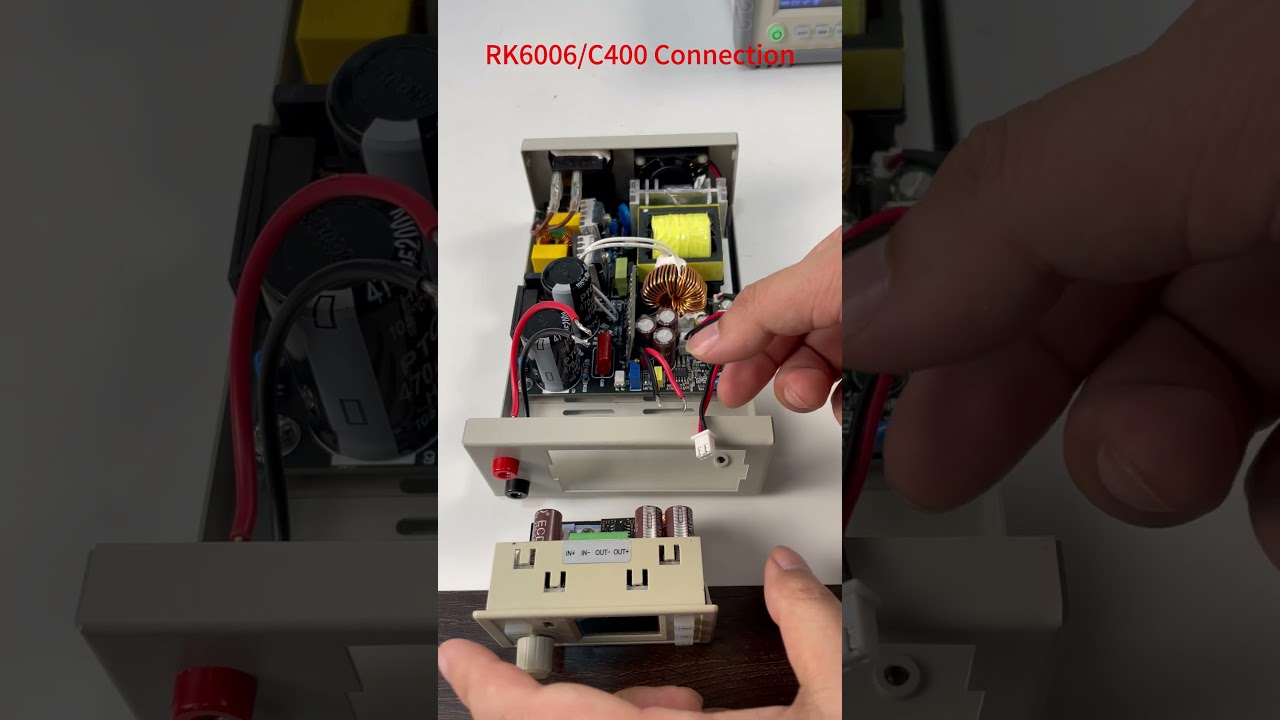

when get the C400 to connect RK6006, there are 5 cables needs to be connected, 2 output cables, 2 input cables, and 1 fan control cable, please connect them in the correct way
