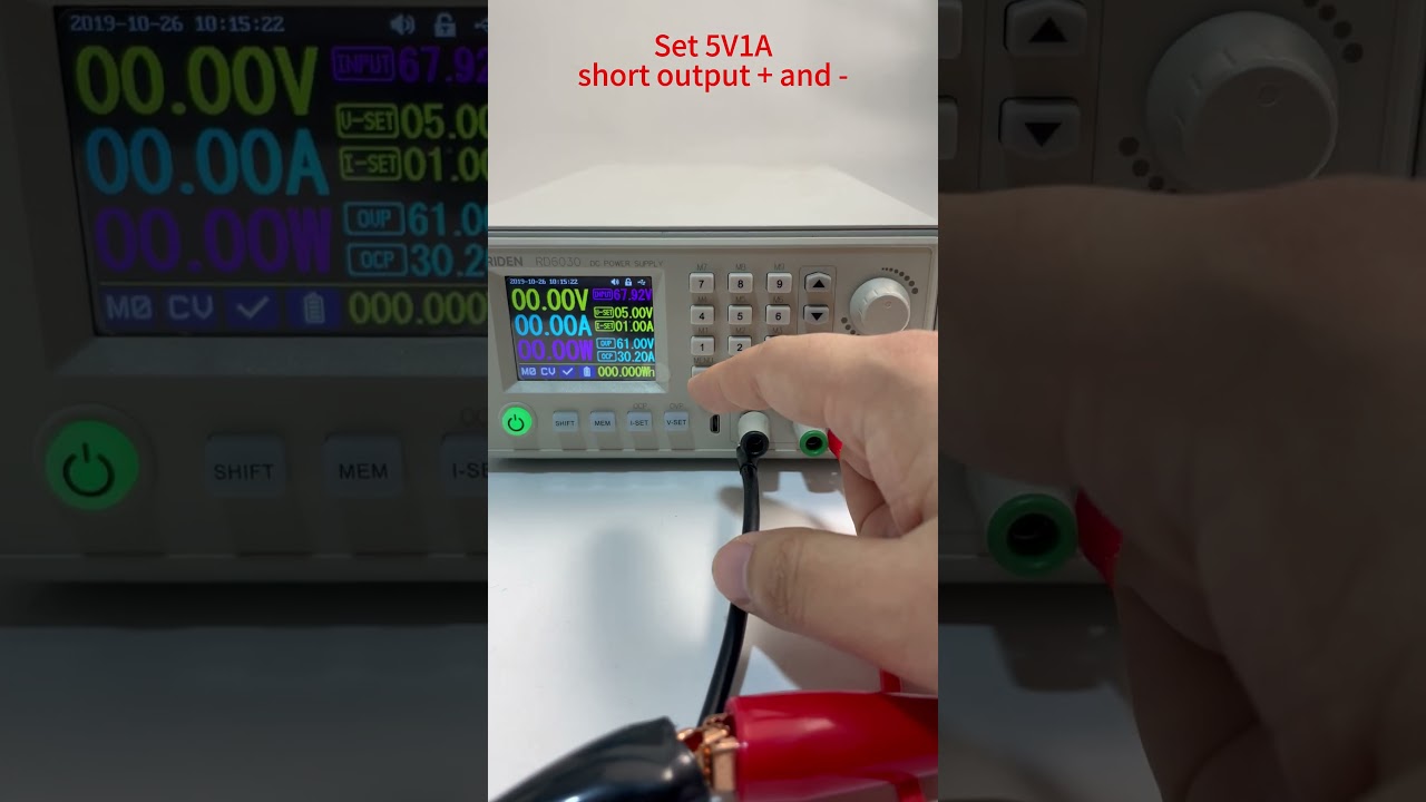

hello, if you find your power supply does not work normally, you can take a video like this to show us 1.if the screen can light, 2. set 5V 1A short the output, let us see the output, then we can help you judge the problem, sometimes just fuse burned

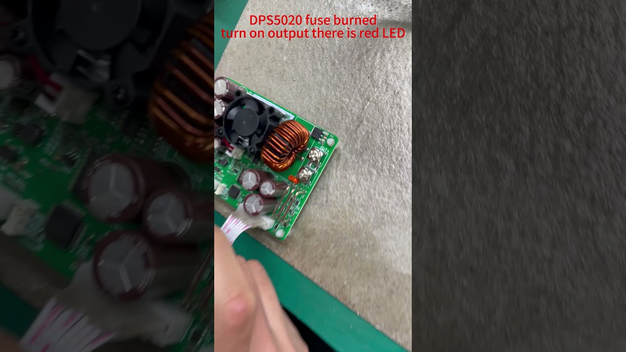

for DPS/DPH series power supply, if you burn the output fuse, normally near the output terminals, there is a red LED, only when the fuse it burned, you turn on the output, it will light

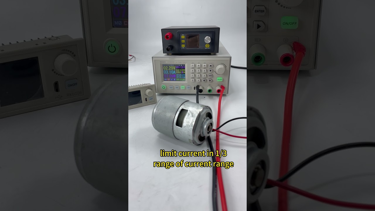

hello, if you are using inductive load like motor as load, then please limit the output current in 1/3 range, not just for our power supplies, most power supplies are same, it will cause big inrush current at the input which may damage the device

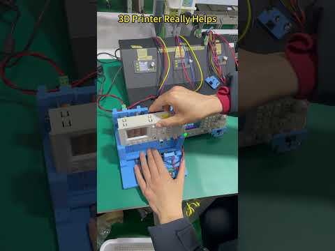

3D Printer Really Helps, we can design different parts and assemble them together, so that we can make a holder for RD power supply calibration, it makes it more standard and less error

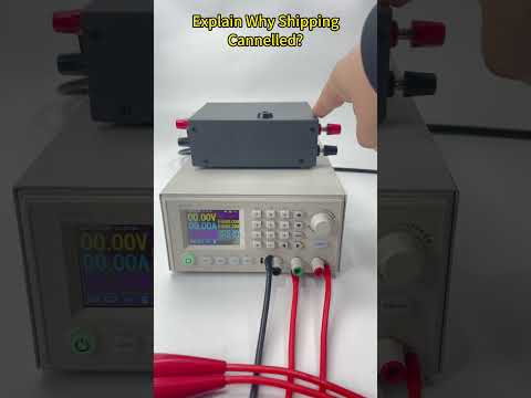

hello, on aliexpres if you see the shipping order cancelled after sending for a few days, normally it is caused in Aliexpress warehouse, it failed at one port but normally they will send it out from another port, the shipping information will update in 1-2 days, no need to worry or you can consult us
