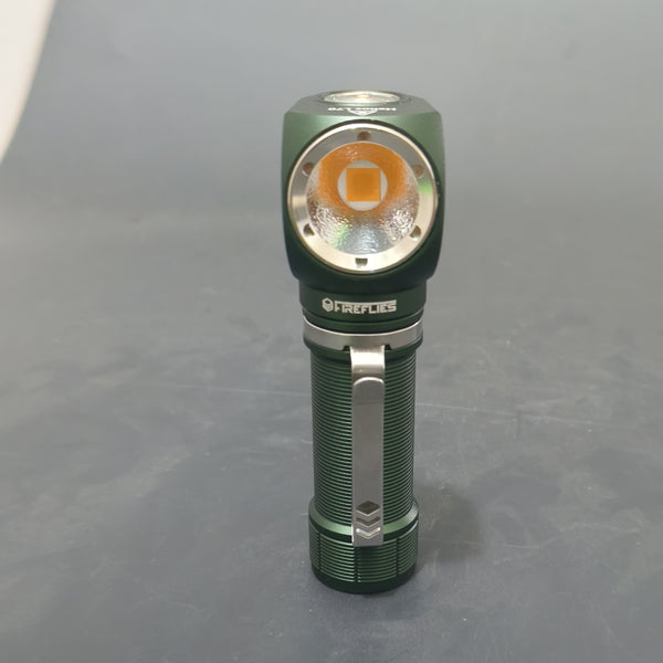

What is the easiest and safest method to unscrew screw-in bezels (lens holders?) like in the FireFly L70 below? Also is anyone aware if there are any TIRs that would fit this light?
https://www.amazon.com/Bezel-lens-removal-SureFire-flashlights/dp/B084BTHNCB
You can use this part of calipers.
Not the safest method though. If bezel is aluminum one this will likely leave some dents. Steel bezels are gonna be ok.
You monster! These are precision measuring instruments that you violently abuse! Shame on you. :crazy_face:
6 Thanks
Yeah, while unscrewing the bezel you also get its precise size.
Win-Win.
Thanks for the suggestion! Though I couldn’t find my crappy set of steel calipers, while looking I found an aluminum ruler that turned out the perfect width to unscrew that particular bezel :D. So keeping with the measurement device theme at least :smiley:
Here is what I use to unscrew bezels. It helps that it is adjustable. Note that this doesn’t typically work on driver retaining rings but it is great for bezels.

The watch case thingy is a great idea, might get something like that just in case I might need it in the future

Thanks. I have what looks like an identical one from AE. I did a little mod to it: the two prongs aren’t exactly at the same height due to the design so I swapped out one of the washers to fix that. I also filed down one of the pieces so the prongs can move closer together (I think I had to do this to get it to fit the Sofirn HS10).
