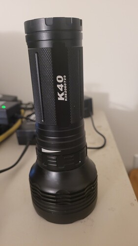

I may read the text all wrong, but isn’t a coat closet the perfect place to provide a runaway cell with ample fuel?
It’s far enough away for me but I guess you’re right. It blows up there will be enough fuel to start fire. I’m afraid to discharge it. Not sure what I’ll do with it , maybe I should bury it underground?
Naw, a coat closet has way too much air. You’d need to pack it in finely crunkled dry leaves, which would provide lots of insulation. ![]()
Can you provide a link to the K40’s description ?
Is that a light with 3 batteries in series ? If so then the flashlight did the charging right - up to 12.6 (12.7) volts. For some reason one of the batteries got unbalanced and reached full charge earlier than two others but since the pack’s voltage hadn’t reached 12.6V the flashlight proceeded with the charging.
This is the reason why series of cells must not be charged without at least a BMS, and a balancer.
EDIT: Probably this is the flashlight, but it seems to have no built-in charger.
This is the reason why series of cells must not be charged without at least a BMS, and a balancer.EDIT: Probably this is the flashlight, but it seems to have no built-in charger.
Supbeam changed their name to Acebeam several years ago.
I did not get any suggestions as what to do with the battery. I wasn’t going to discharge it and I wasn’t going to leave it in my house.
I did what I had to do to protect my family and my people. There’s not many of us left.
My cousin’s an engineer. Here’s what he said.
See screenshot.
I think he’s right I probably put that one battery in backwards .It makes sense with the output which was very low
Thanks for posting the likely reason for the interesting event you described as I was wondering what could have caused it.

Also, I really dislike lights with more than 2 series batteries for this exact reason. With 2 batteries, if you put one in wrongly, they just cancel out and nothing happens.

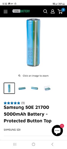

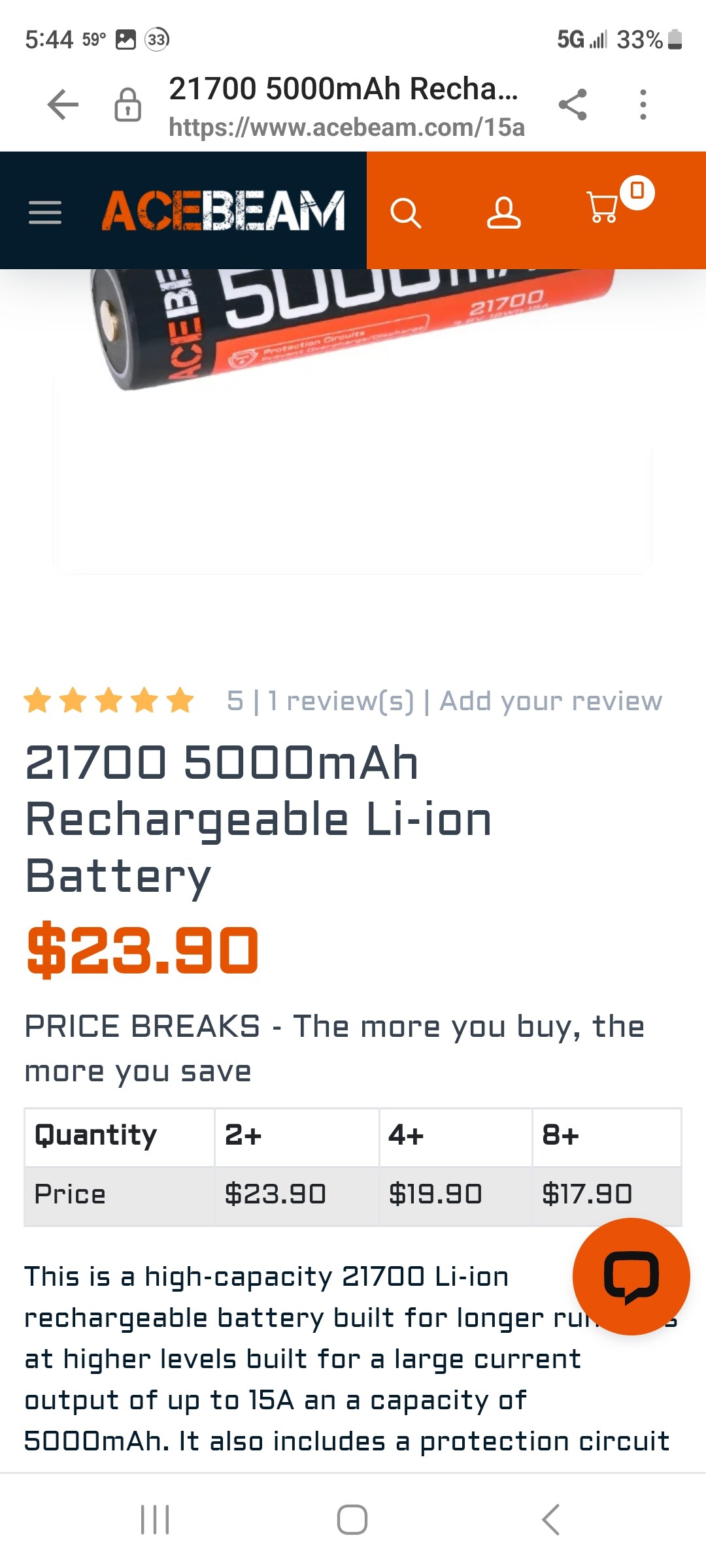

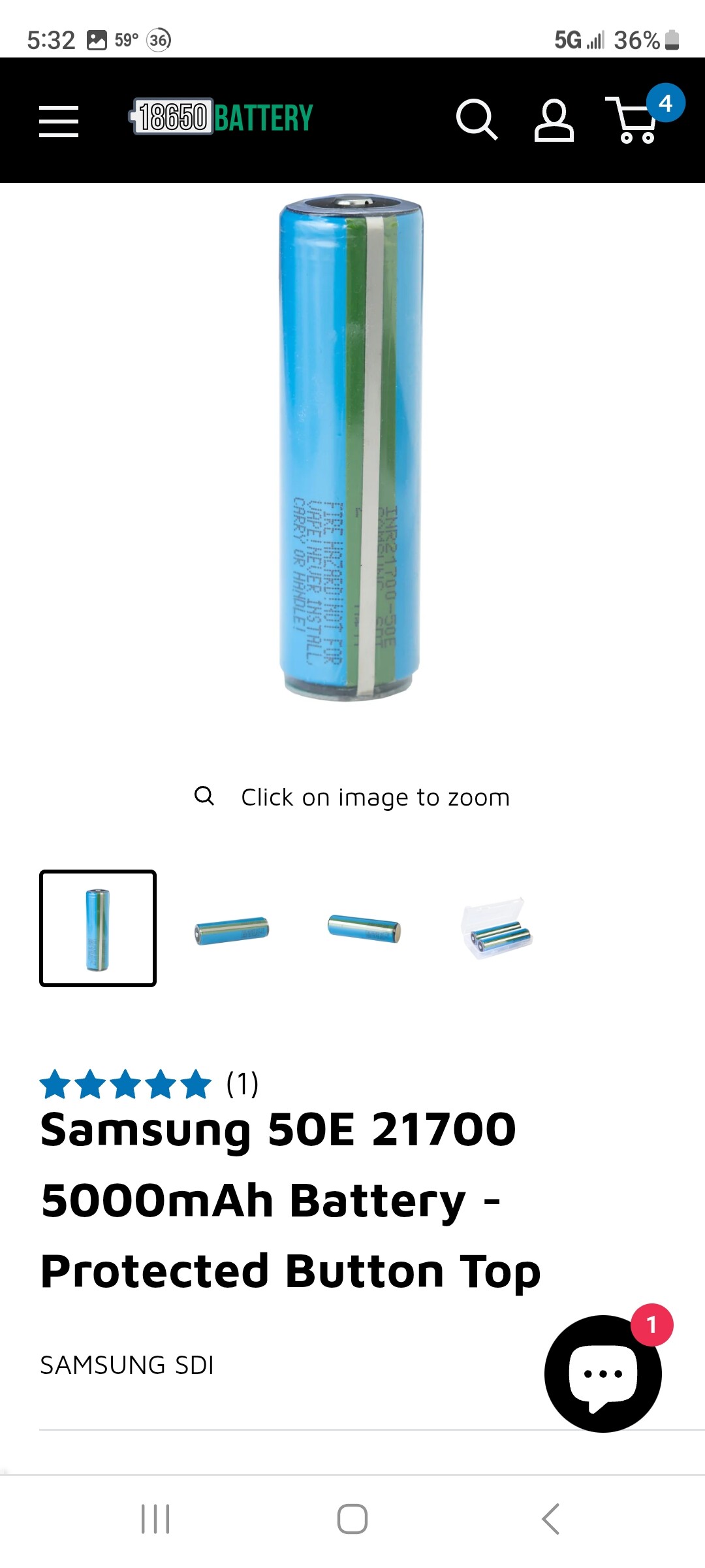

What cell do you think is in the Ace Bean 5000 mAh protected BT 21700 battery? It claims to be 15 amp. The 50E, with the same capacity claims to be 9.8 amp… further down in the description.
Who knows. There’s a number of possibilities. E.g. Eve 21700 50E.
Yeah, it’s tough to tell without removing the Acebeam wrapper. ![]()
Ok. To narrow it down what other 21700 cells…5,000 milliamps and claim to be 15A besides Eve which I have no idea if that was tested and verified.samsung 50E is 9.8A

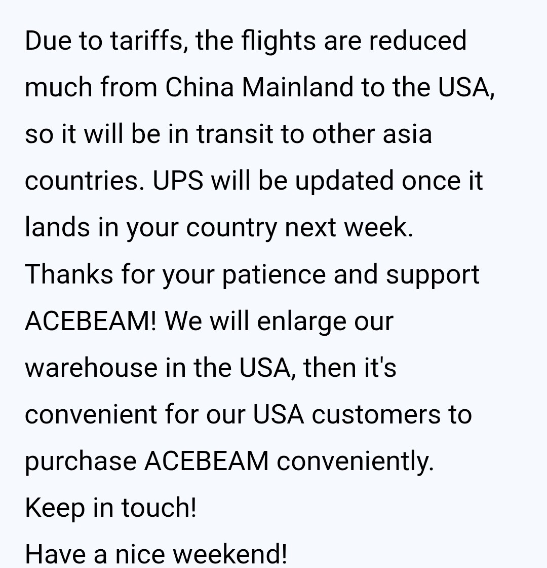

I didn’t want to start a new thread for this. So I thought I’d put it here. I’m getting the ace beam x25. They sent me an email with tracking. I noticed that it is UPS.
I asked them I like to track it from Asia to United states. And that was not possible. Not sure why they can’t have tracking from those other countries but I’m glad by doing it that way there’s no tariffs on it. Explanation with screenshot below.
If the warehouse in the US is enlarged and more Diversified, and there won’t be an issue at all with shipping to different countries and possible tariffs. At least I hope there isn’t!
