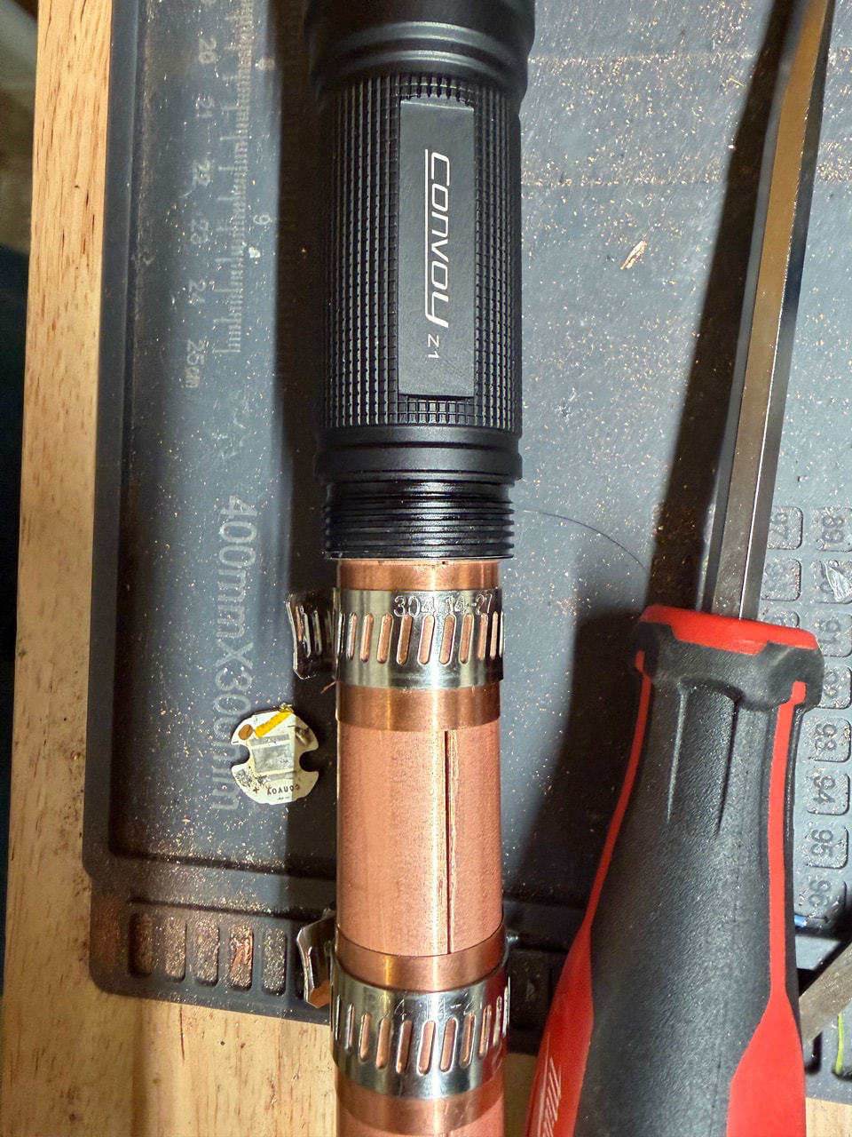

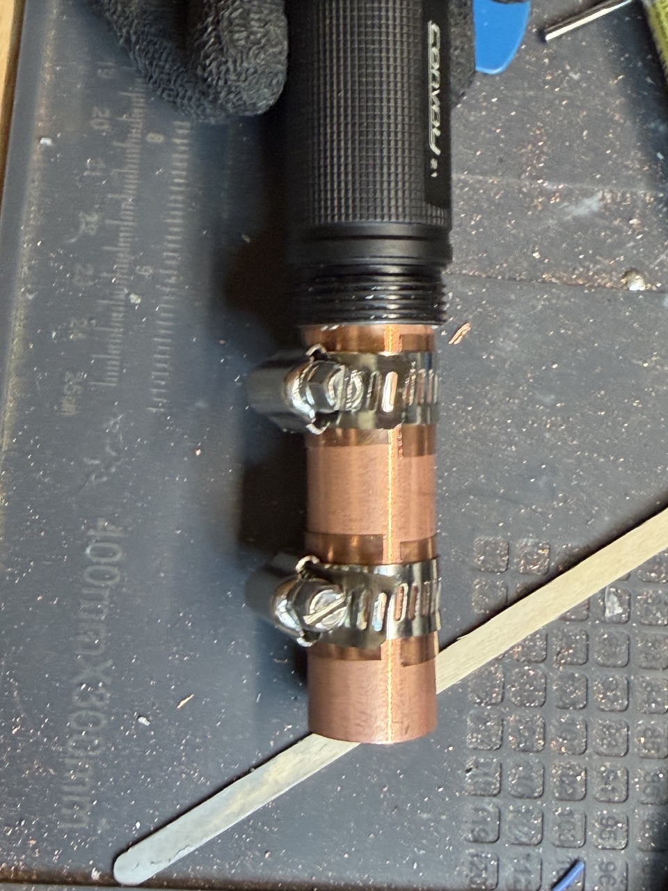

I’m trying to slice a 2mm slit on a 22x19mm cooper tube to try squeezing it inside a Z1 tube.
The plan is to wait a spare Z1 to arrive, pre-squeeze the cut copper tube with a clamp and mallet it on the Z1 21.8mm tube using thermal grease.
A cooper tube would be massive and heavy for your flashlight, but an aluminum one could be feasible.

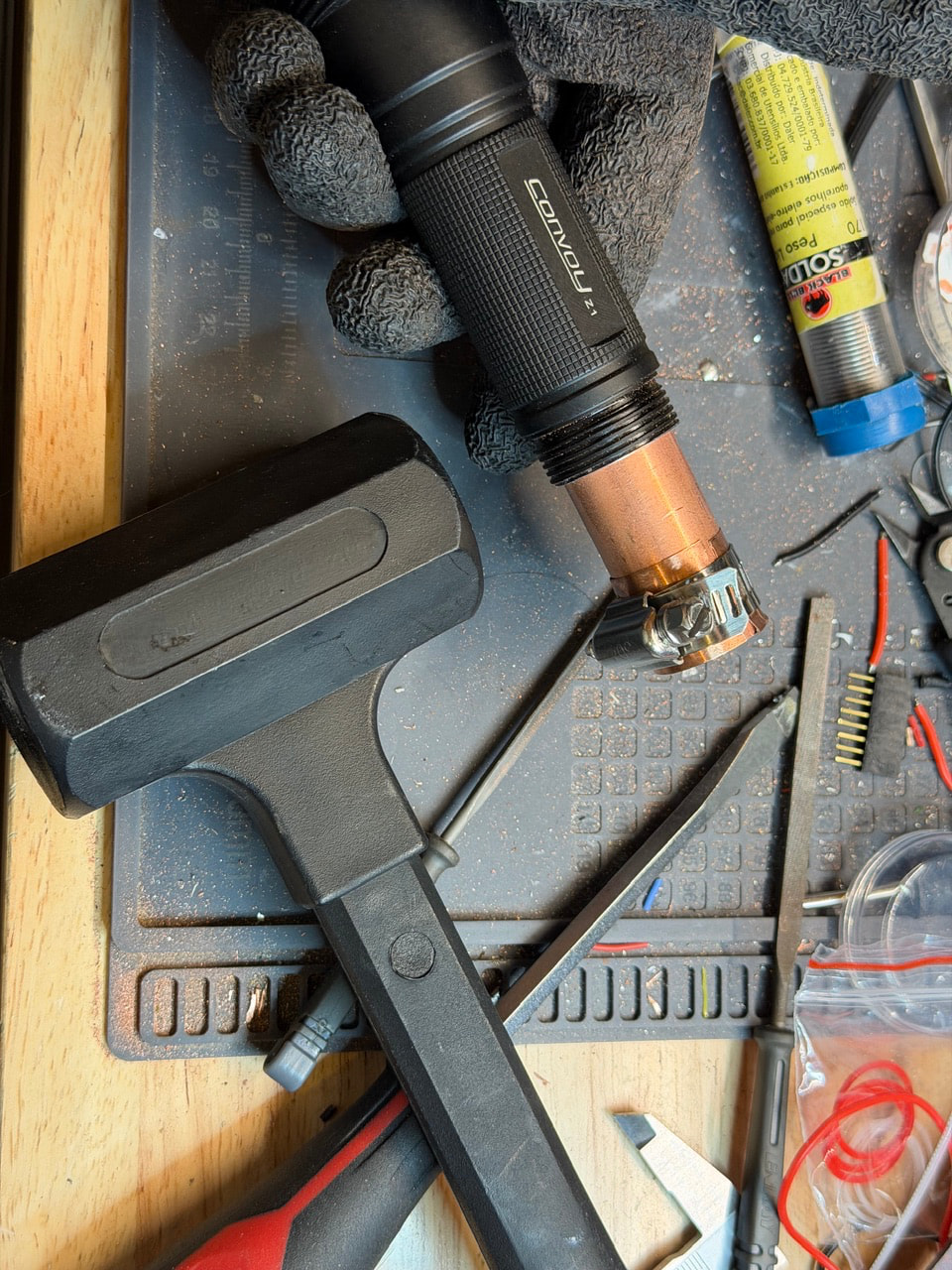

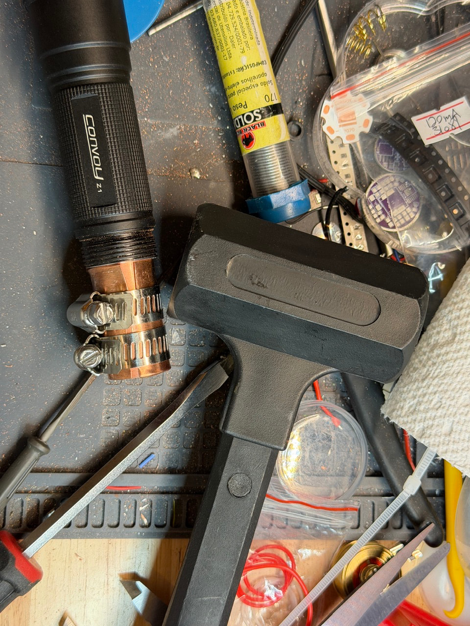

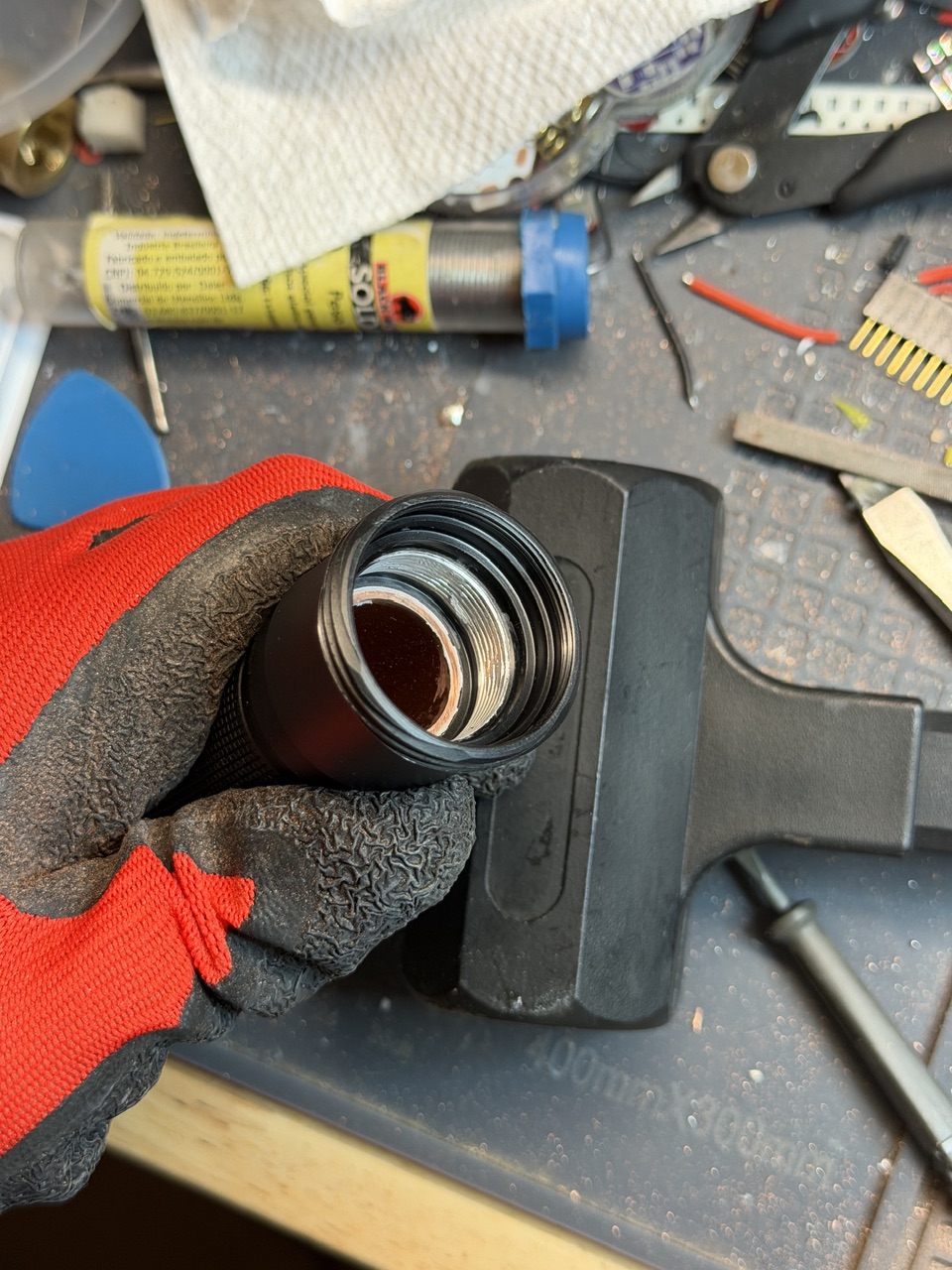

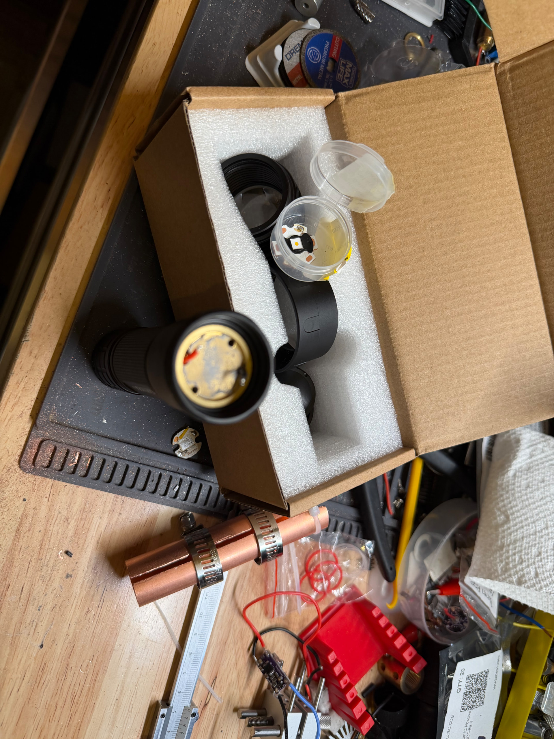

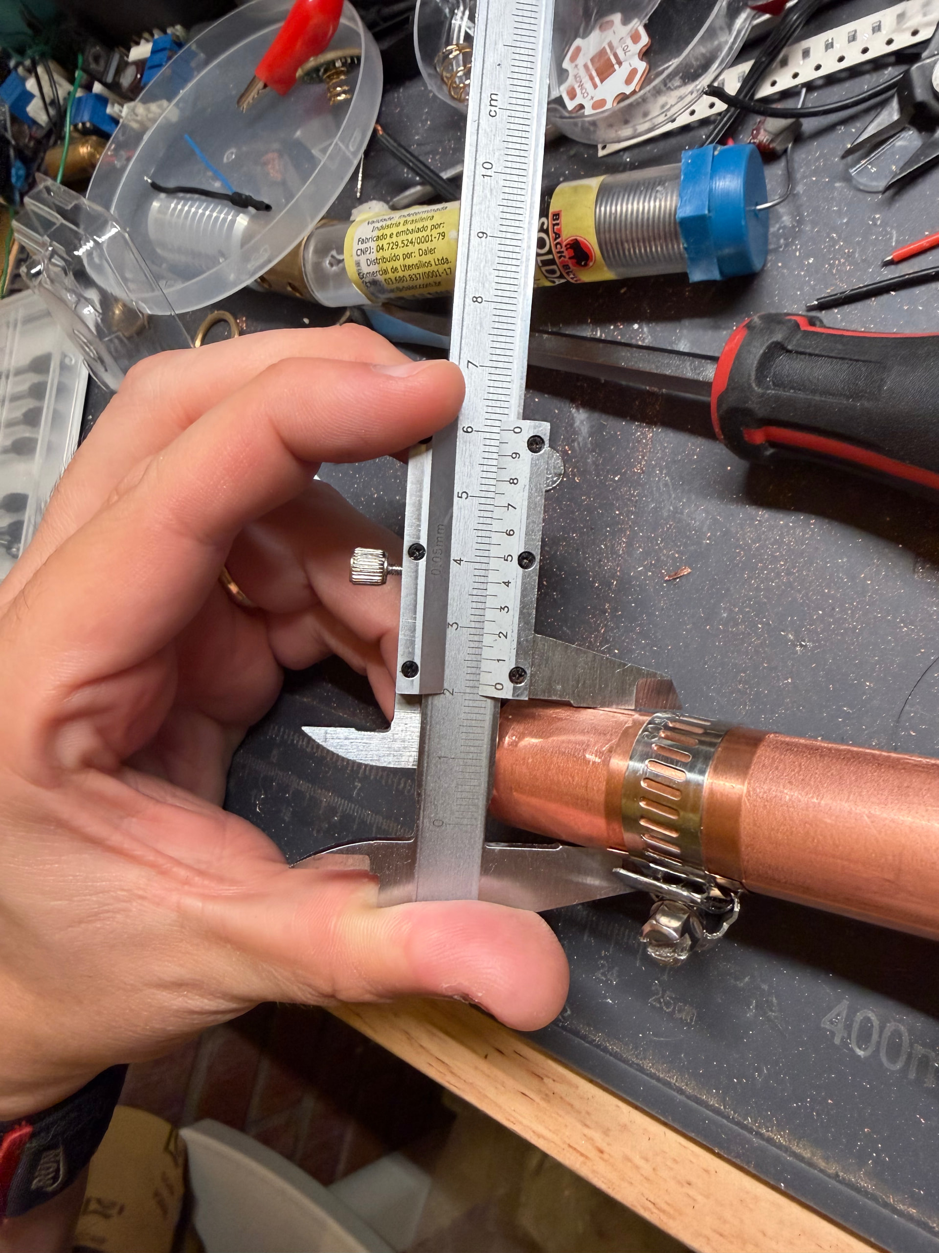

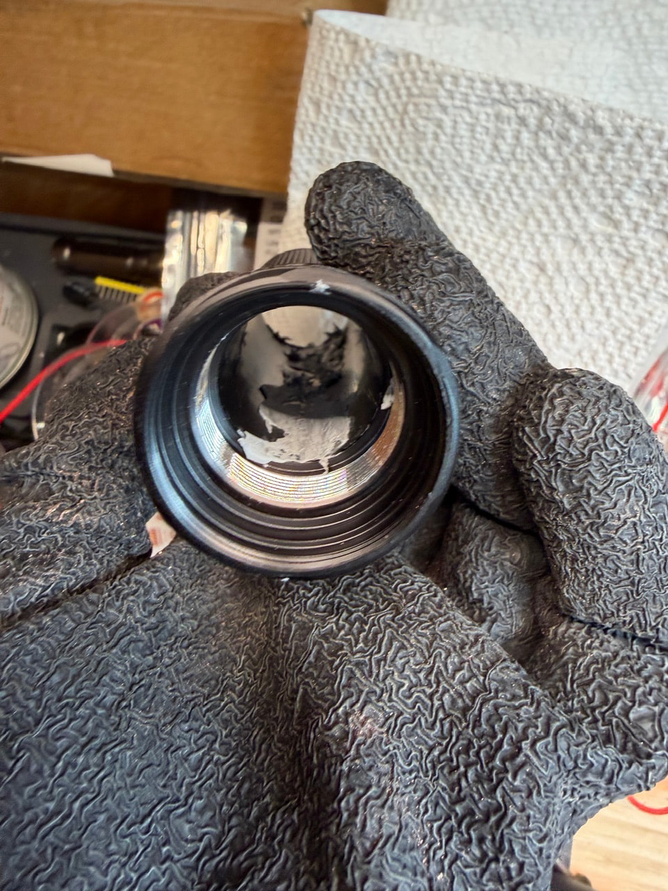

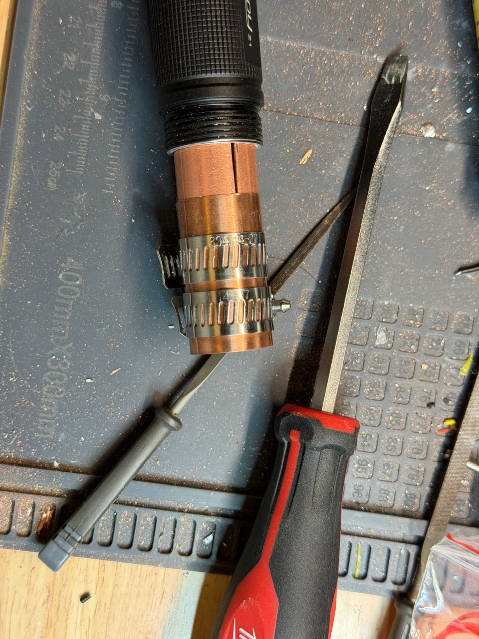

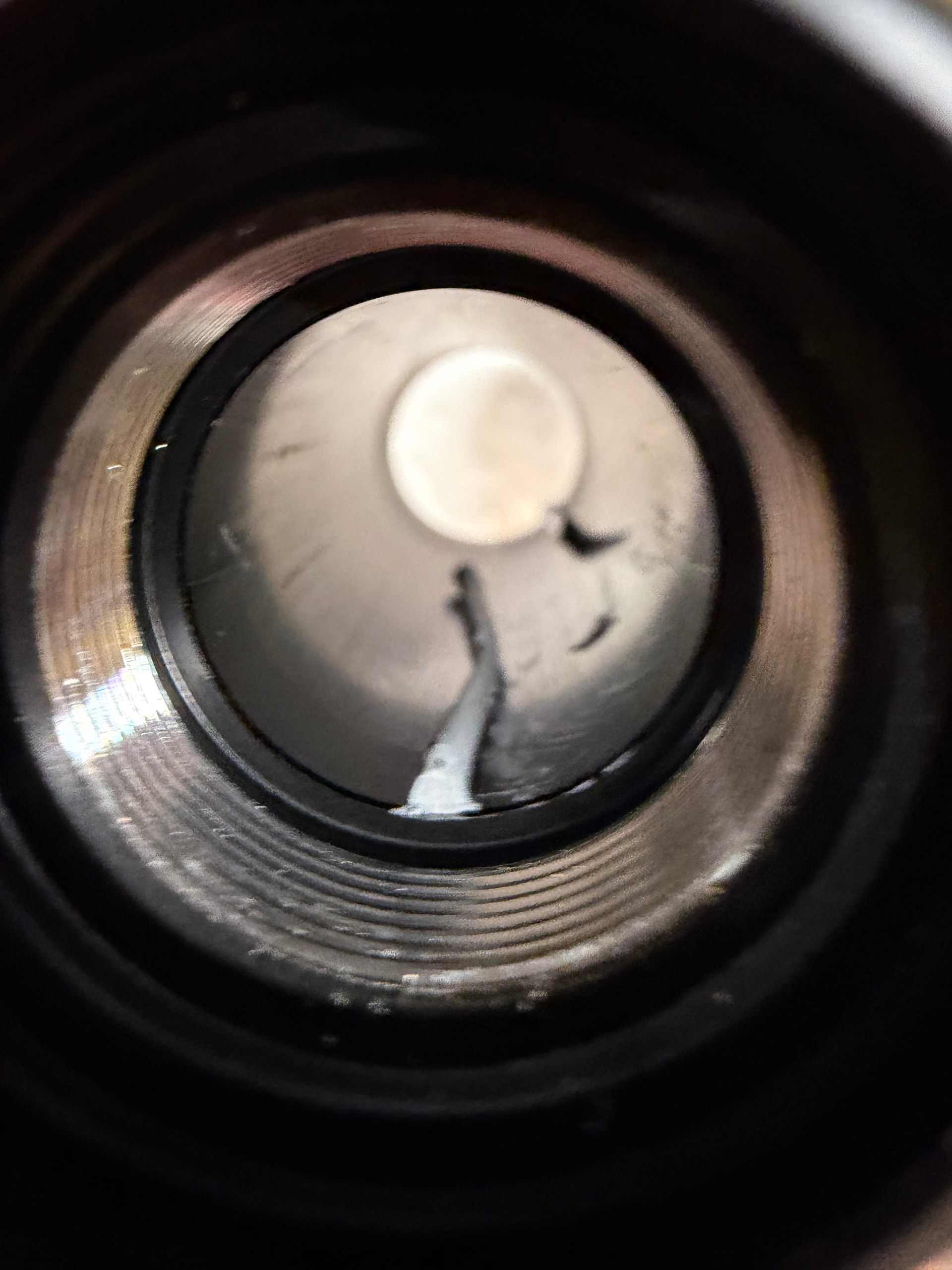

I’m documenting the process of switching from 21700->18650 plastic adapter to a inner copper tube on a Convoy Z1:
Nice!
