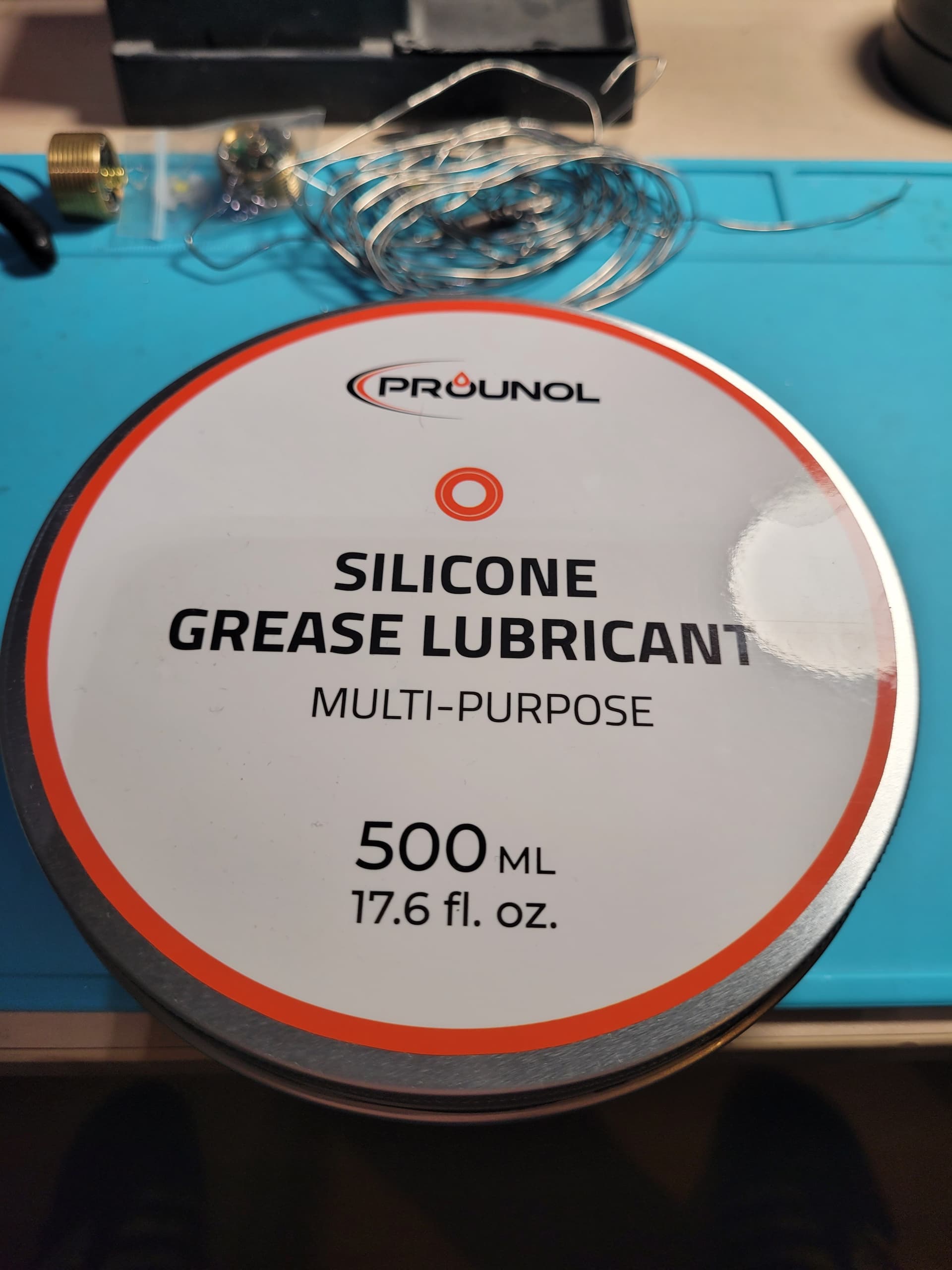

Curious what does “not compatible” mean.
Agreed except for personal preference but it’s not a silicone grease eh.
No grease is food safe except bacon. When a grease is labelled H1 it means it’s rated for incidental contact where less than 10 parts per million ends up in the food. More than 10ppm and it’s a recall.
And the ones that arent silicone, the ones that just say synthetic or multipurpose are petroleum derived.
