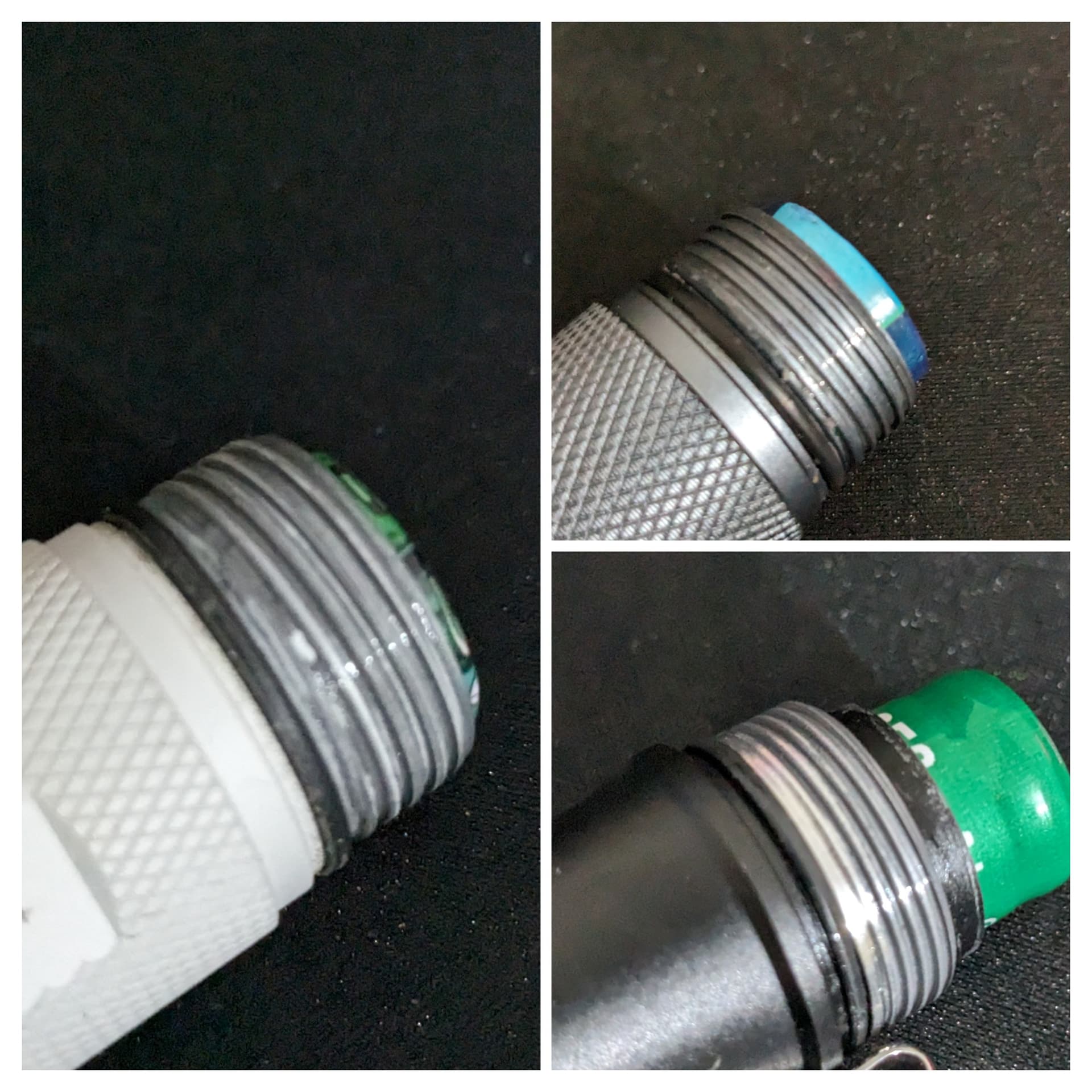

Can you share a photo of your S2+ threads?
The lube is most likely turning grey from the aluminum (or whatever material the threads are) rubbing off when the head or tail is screwed on and off. Or it could be from the O-ring deteriorating.
Lube helps by putting a slick surface between the threads, but it doesn’t at all times and that’s when the aluminum scrape against each other and wears.
It helps to relieve some of the spring force on the threads when assembling and disassembling since that will reduce the friction. You can do this by pushing in a little on the head or tail to try to float the threads in-between each other.
And with the stiff copper springs that Convoy now uses, there’s a lot of force on those threads!

From the reading I did since I posted, I think you’re right. There were a few posts on CPF about it where it was generally agreed that this is just a thing with bare aluminium threads.
I just realized the S2+ threads are anodized and the lube still gets dark. MAO is the worst. The TS10 threads are un-anodized and the lube on it gets darker than the anodized ones. All these were lubed around 6 months ago.
I see a lot of grease on those threads :sweat_smile: a microscopic amount is really enough
