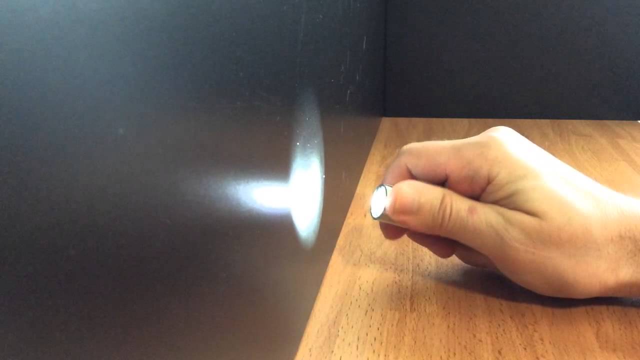

The version that I analyze is the Cool White, i really like the tint of the T10, it is neither too cold nor too warm, I guess that goes for about 5000º K, has a very good projection, free of rings, with quite blur center spot, the moonlight mode is actually very low, and I was rather surprised that it has good performance in high mode with NIMH, but even more with lithium, the truth is that I think more than twice, you must pass the 400 lumens with lithium, so if it is heated with NIMH in high mode, with lithium better i don´t say anything.
Modes:
Comparative high mode with Olight A3T (1xAAA) and SolarStorm SC01 (1xAA):
Comparative in low mode (moonlight) with Olight A3T:
I steeled myself and I put a 14500, here are some comparisons:
With Roche F6 in high mode:
With Roche F6 in mid mode:
With less exposure time, high mode with F6 and Roche SolarStorm SC01:
Comparison with / without diffuser:
