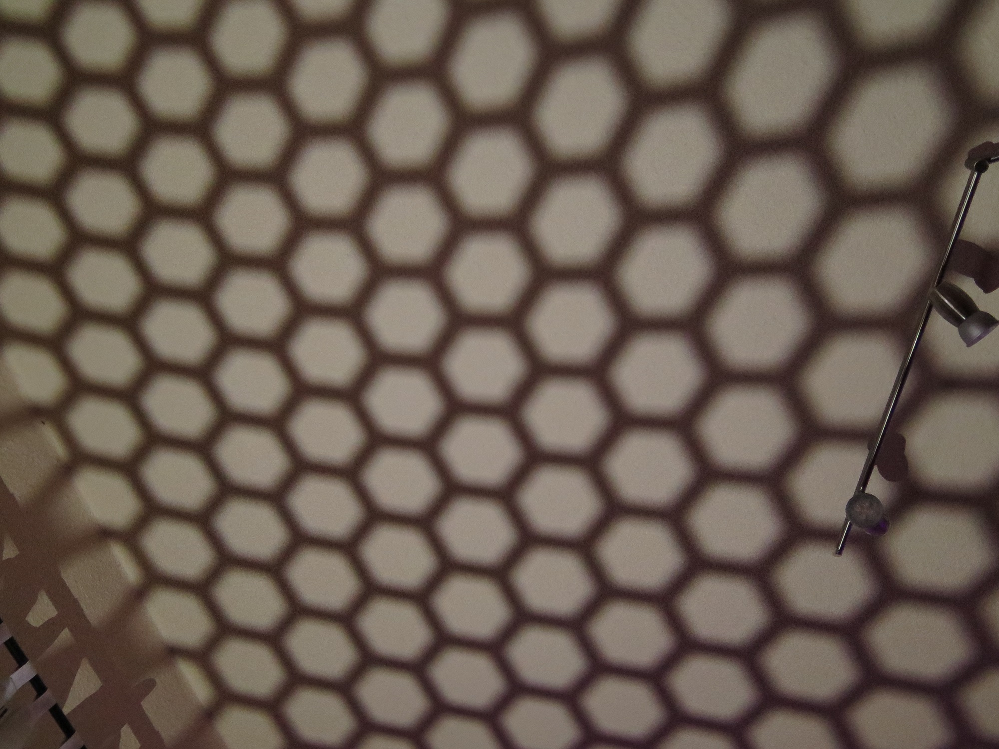

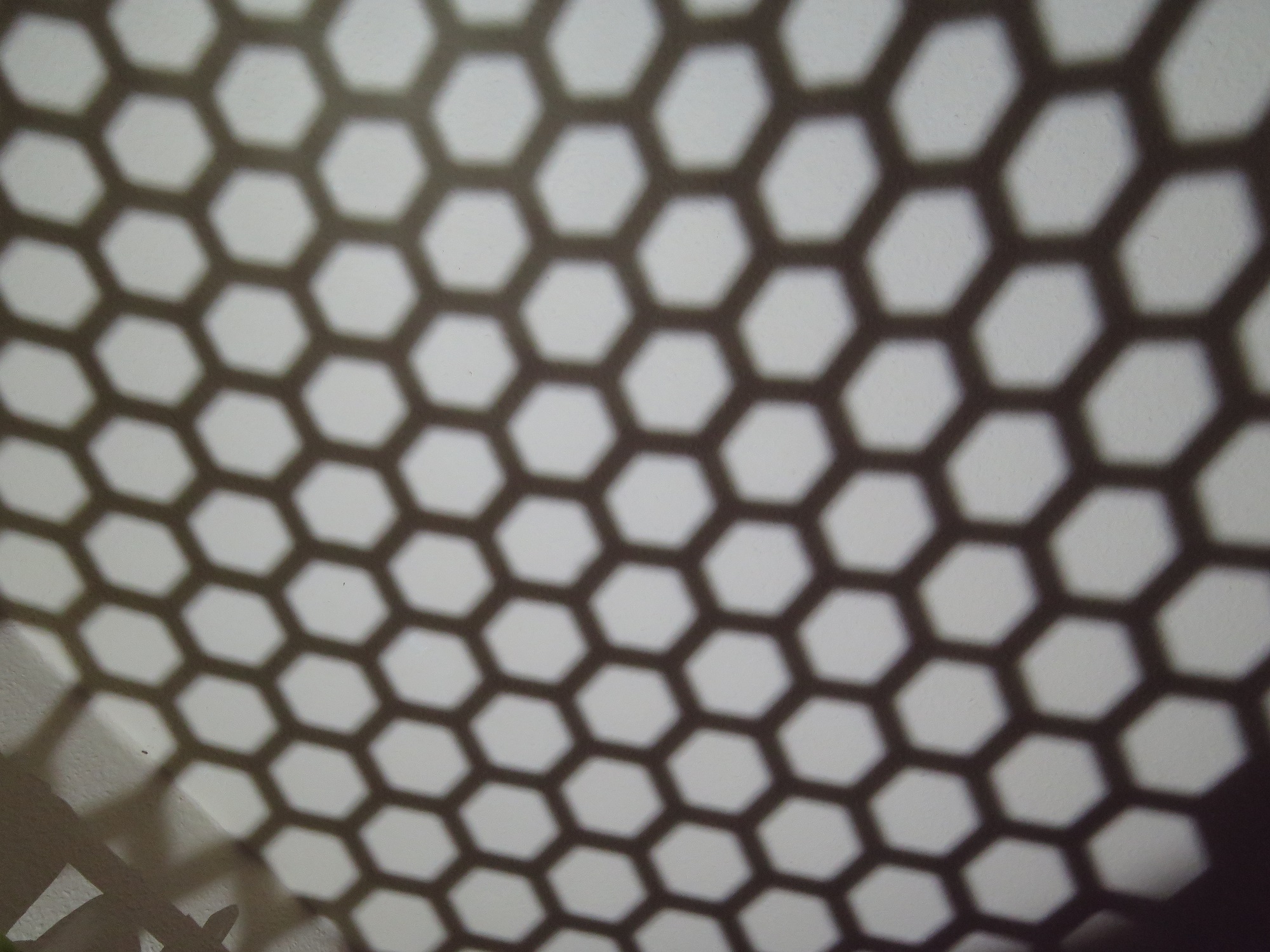

The closest I have to a solution is this:
It’s a festoon bulb to fit car number plates or reading lights. It claims to be 250 lumens and is in fact incredibly bright. The tiny single emitter means that there is almost no blurring of the shadow on the floor. I can house it in a waterproof case and use standard car bulb fittings.
However, I need a bit more oomf! I think that I could really do with 400-500 lm.
The only things that seem to be able to do the job are the cree xlamps. However I can’t seem to find that in any consumer product (such as a car bulb) as a single smd.
What I’ve tried:
Cheap chinese Creee Q5 torches give me quite a nice light and crisp shadows, but I obviously cant hook this up to the mains.
0.5w strawhat led. Perfect light - way too dim
10w COB floodlights- Perfect brightness. Weatherproof. Unfortunately, they cast a fuzzy shadow.
3030 superblock 1.4w 120 lumen module. A bit fuzzy and a bit too dim.
