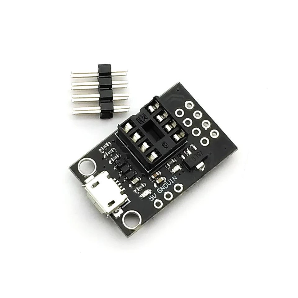

TK, can you tell me if this is the right board?
Then some pogo pins, the progkey and cables.Is that enough or am I missing something?
