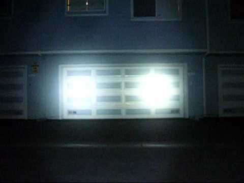

Here's a video I made comparing the TrustFire X9 with a Keygos Ke5 and a Husky 2D.

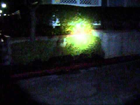

Here's a video of the X9 going out to 500ft in an urban, light polluted area.
including crapy batteries and charger ...
