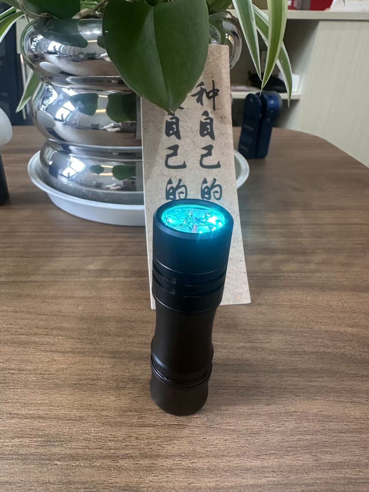

21700 with quad LED?
Can’t really tell the number of LEDs

Okay, i think that is a TS10V3, although the change is not significant, update to buck driver~
What kind of upgrades can we expect more?
