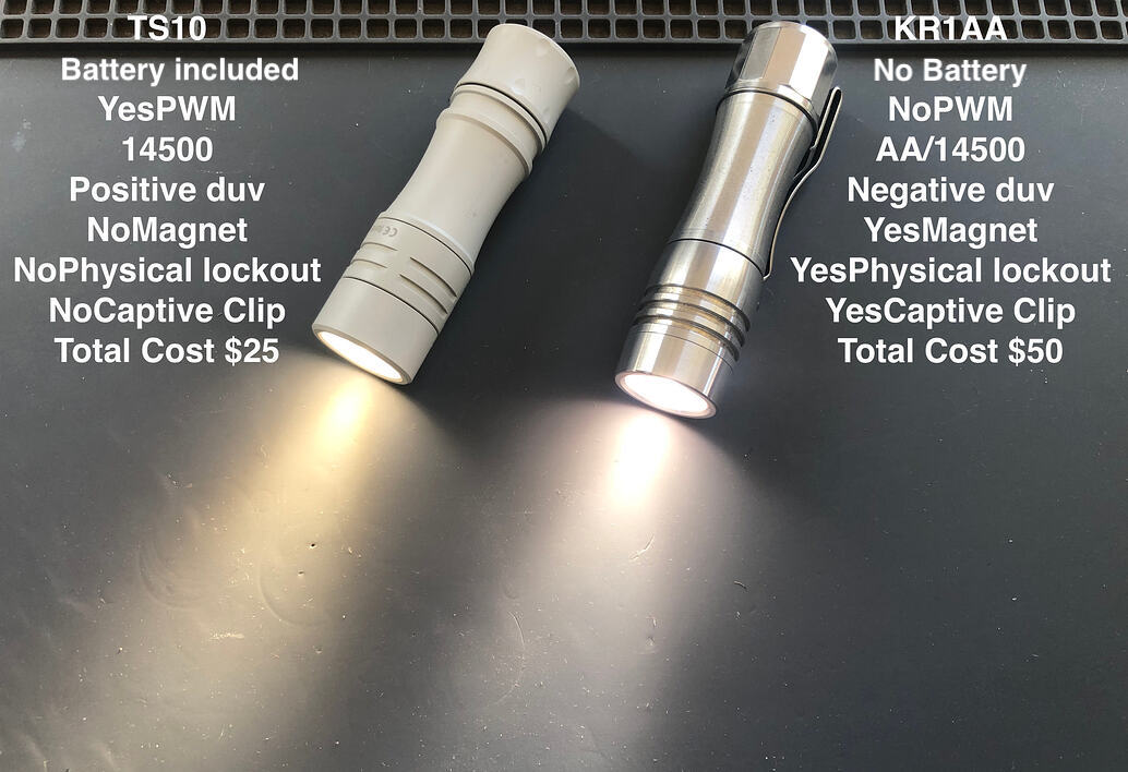

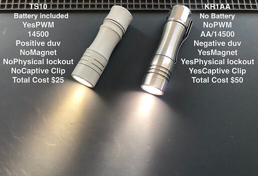

compare and contrast:
6 Thanks
The TS10 is way cheaper. This is what most people want, it has to be cheap.
7 Thanks
Yeah all true…
However. I don’t need or want a magnet. I have never been able to visually detect any PWM flicker. I have never used the physical lockout on the KR1aa (problems with the tail cap reported). Negative DUV is nice, but I don’t see it as being a deciding factor for the great majority of buyers.
The captive clip on the KR1AA seems to be more of a hassle then it is worth (O-ring eating).
No idea what a new one would cost. But I got several TS10s over time for as low as $12.
Bottom line is the TS10 was a much better deal for most folks…
So I wait anxiously to see what they do with a V3, while I plan on what I would order for my next KR1AA… after availability resolves itself and they hopefully iron out some of the bugs.
