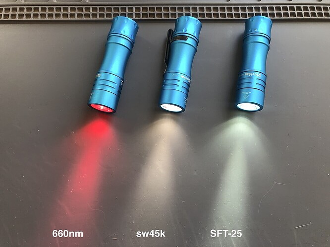

on right is the stock Low CRI SFT25, it throws much more than other LEDs Ive tried.
And it comes with a power source
good point, added that detail to this comparison

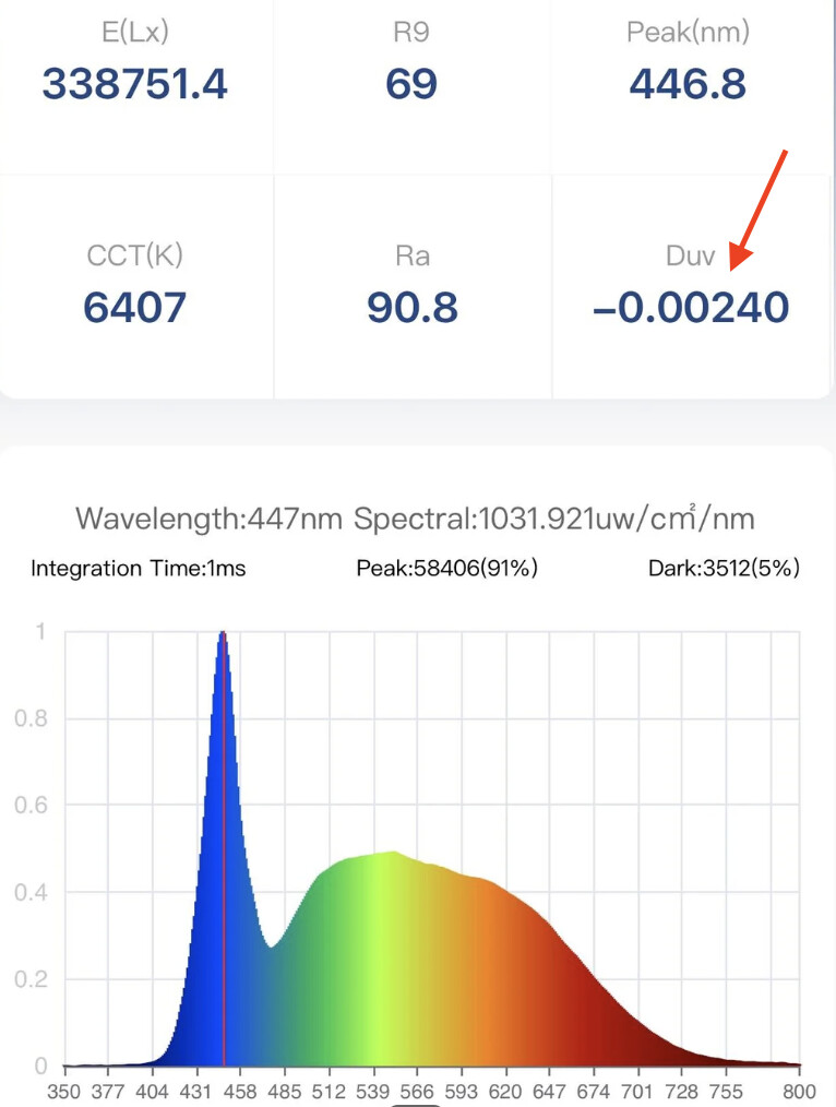

I also tested it here
thank you for your test, it shows duv -0.0001 and R9 >80..
I see the results are different when tested in a Convoy T6 (also depends on output level) duv -0.0024 and R9 69:
Could just be the variation in color bin from production
