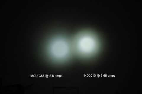

I have to say my initial disappointment with the U2 upgrade is gone after testing it outside in the dark. While it still doesn’t put out the streetlight it definitely picked up some more brightness in the corona. When compare to my C-88 with a U2 and a 3.5 amp driver they had equal corona brightness before with the T6 now the HD2100 with the U2 and the 3.8 amp driver overpowers the C88 corona so there is some visible improvement. The thing is just a plain bad ass thrower easily the best thrower I have. I desperately need to get a light meter and make an integration sphere so I can get some actual measurements on these upgrades.

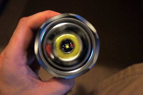

So I think I might buy another one. Here’s what I’m thinking. My hotspot isn’t the greatest, I think because the emitter isn’t far enough inside the reflector. I think my wiring is too thick. I’m thinking of drilling the reflector out to remove the flat section, which should allow the LED to find the sweet spot in the reflector. This can be adjusted by screwing the main pill up and down.

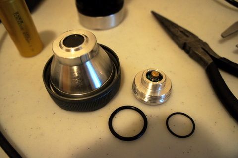

Alright, so I drilled out the stock reflector (of course while trying to remove the metal shavings I blemished the reflector) so that the emitter could sit higher in it, which I think creates a much better beam (at least in my case). To raise the emitter up I got a different o-ring for the pill so that it doesn’t screw as far in. Obviously not great for thermal transfer as a metal bushing would be better, but it would be too pricey to source one at that specific size. I have to be careful screwing down the bezel as the reflector gets dangerously close to the reflector. Luckily I had a protected cell in at the time as it shorted out a few times while I was playing around with it. I really should bore out the reflector more, but it should be fine once set.
On the right is the stock o-ring, left is the new one.
And here is it compared to my MCU-C88 w/ XM-L (unknown bin and tint)

Before I could basically describe the hot spot to be splotchy as it was just behind the focal point. Now it’s more solid. Again, it might not be like that for others as their reflector may be able to recess further down. It might just be that my wiring/solder is too thick.
