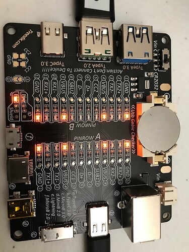

Got it in.
Mine doesn’t have the battery clip problem that many reviewers complained about.
The on board connectors do look and feel rather breakable. Especially the Micro USB socket.
Reviewers often have this complaint. Micro rips off the board.
After bit more careful playing. I think a tiny drop of superglue on each socket might give me more confidence that I won’t rip a connector off by applying even a small amount of nonlinear stress.
A couple of quick pics below.
I’ll do a longer review when I understand it better.

Easy to tell Charge from Data.
But I’m not sure it will define a miss-wired cable. Would be nice if the connections would cascade like on my serial breakout box.

A to C with Data - Basic cable.
A to C – Charge only.
Yeah, if wires are crossed in a certain way, I can see where it could light up the “correct” lights on both sides. I looks like it is just a continuity checker. Still interesting.
That’s all it is. But I do see contact points next to the LEDs.
Perhaps a meter could be applied to those one at a time and see where it comes out on the other side.
Maybe even a voltage to light up the corresponding LEDS.
Need to think about that some.
But at least I can now quickly cull out the charge only cables.
