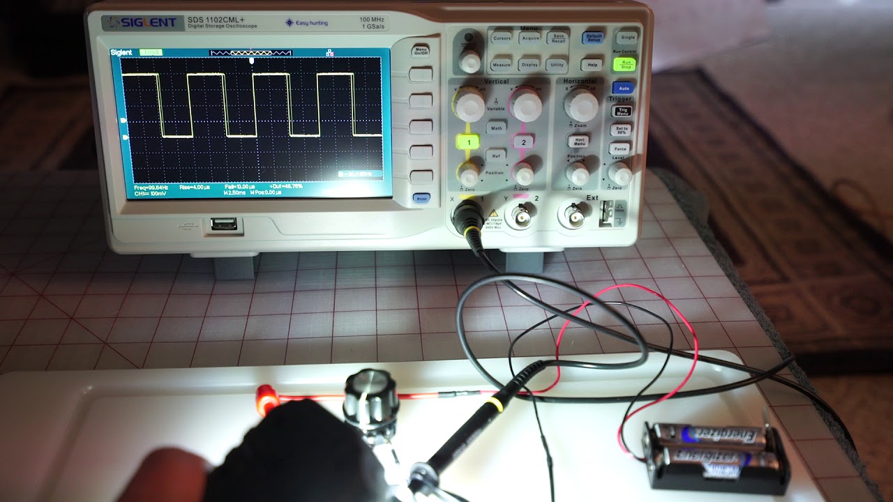

On lights with a fast PWM the waveform is distorted. For example here is a look at fast PWM.
Here is my C8
And again on a real O-scope.
You can also miss small but significant ambiguities. Take a look at the leading edge of this trace.
See the big overshoot before the main square wave? The soundcard sample rate was too slow to see this.
