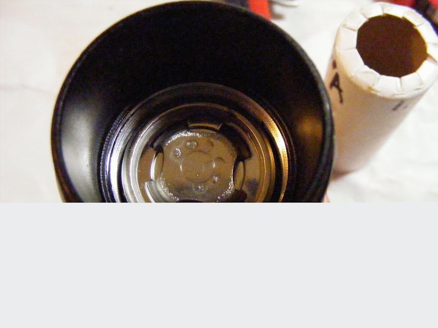

I really like the husky style of the Utilitech/Defiant 4AAA. Like most here, not too fond of AAA cells in bigger lights. Also, the light does not have an attractive beam pattern with the XPG2. I hoped a bigger emitter would smooth out the ugly transitions in the beam. There is also a lot of empty useless space in the light.
The light appears to be able to take a 26650 without the wrapper. At least, it can take a Moli 26700 without the wrapper. Sorry, I'm having camera problems.
