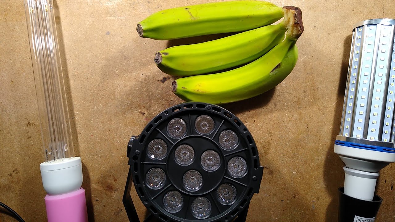

To test for UV-C, Sunburn a banana. UV-C LEDs, Questionable.
