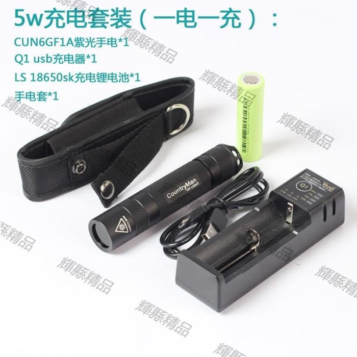

I found exactly one picture of this light, and it looks very much like a Convoy S2+ UV: Convoy S2+ black UV 365nm 18650 flashlight with Nichia 276A - Convoy flashlight with the “ZWB2 filter” option
Convoy is one of the most reputable budget-flashlight manufacturers out there and highly respected in the budget flashlight community
Hope this helps!
Edit: Nearly all articles that they sell are marked as sold out during the chinese new year, so don’t worry, it will probably be available after Feb. 8

Well done L4M4 for finding this photo, because thanks to the title I’ve found a piece of information I was missing, it would be a 5w flashlight. Do you know the wattage of the S2+ black model you recommend? I can’t find the specifications on the website.

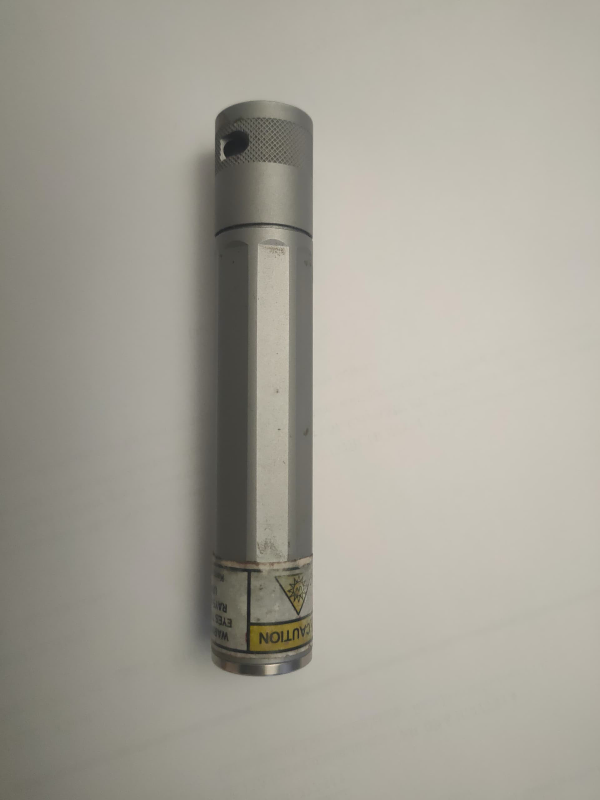

A short while ago, I bought an Alonefire SV65. Just out of curiosity how a light performs that costs three times nothing.
Alonefire seems to make dozens of versions of these lights.
Sc97a95c2225644a49eb6a84f714367ed5.jpg_220x220q75.jpg_
Well, apart from not being a UV-thrower and having just one mode, it performs pretty decent.
A quick comparison of it with some of my other 365 nm lights is on my to-do list.
