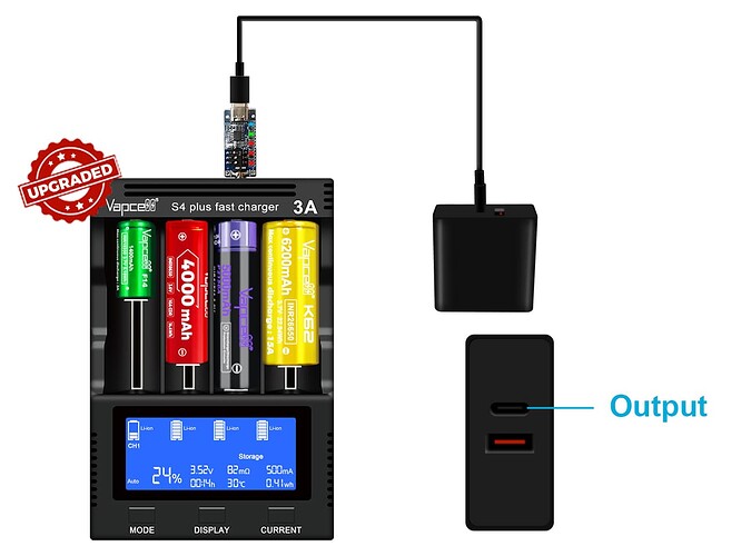

We provide a conversion head solution that can be more lightweight
The adapter requires a power of over 65W and USB-C output
This conversion head is sold separately?
65W is only needed if I use highest charge current on all slots? Would make sense
Oh wow, that’s wonderful. Where can I buy this adapter?
I just bought two S4+ V3 from Illumn yesterday.
Will soon be available for sale on retail and wholesale platforms
As it is a DIY product, manual operation is required
If the adapter power is not appropriate, it may cause it to be unusable
By default, conversion head accessories are sold, and customers need a backup high-power USB-C cable and high-power adapter at home
We expect to provide a complete set of DIY accessories if the customer does not have these accessories
If I only want to charge with a low current, e.g. 4x 1A instead of 4x3A, it should also work with a power source with less power?
It looks like a USB-C PD trigger, but I don’t know much else about it. The charger works on 12v 5A, and the previous USB PD 2.0 spec only goes up to 12v 3A. The 12v output is no longer available in 3.0, so I have no idea how they’re making it work unless bucking down from 20v.
