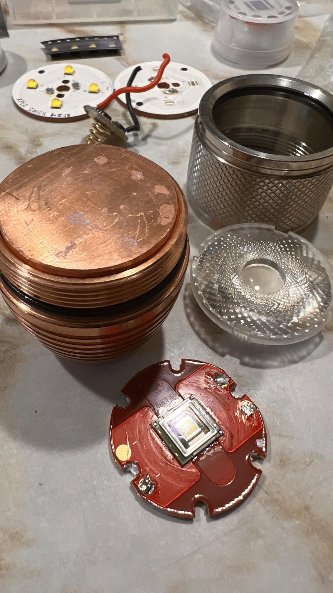

I set out to modify a SS/Cu X6 with a really low profile optic over a 90.2. Had to make a spacer to raise the emitter due to the low profile optic.
Modified my complacency instead…
With 7 stitches in my fingers I now have some time to analyze how I can achieve this in a safer manner. ![]()
Oh boy, Dats Tuff !
Been away from this kind of mod for too long, forgot how bad copper is about seizing. Tried to hold the copper disc on a wedge of wood to angle wire holes through on the drill press…. Seized and bit me!
This is why they call it “red copper”… ![]()
Hope the throbbing isn’t too bad and it heals up quickly!
I learned pretty fast that copper is grabby. You can “dub” your bits to help, and I think the traditional 118° tip angle is supposed to be more forgiving here than the usually-on-the-store-shelf 135° these days. Lead is even worse, if you ever have the misfortune of needing to drill lead.
I learned to buy bar stock copper with Beryllium , even 1/2 of 1% Beryllium greatly enhances machineability.
This time I wasn’t using the lathe and the 1/4x 2x6” flat bar was unmarked in kit I bought from Old Lumens years ago.
And yeah, been too long and too much has happened. Just forgot. I remember now! Lol
Alcohol helps.
I mean drilling holes in copper, aluminium can be cooled with denatured alcohol or IPA. Or propper cooling fluid for copper.
Get well soon! ![]()
And be carefull with beryllium copper dust. I think the marines aren’t allowed to grind their CuBe blades by themself.
