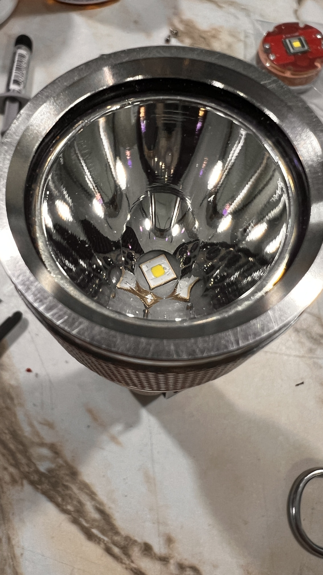

Well, after going to a lot of trouble (and stitches even!) to make a copper spacer for an SS/Cu X6 in an effort to utilize a shallow optic paired with a 90.2… it’s a bust! This optic doesn’t play nice with the 90.2 emitter.
So I regrouped. Re-flowed an SFT40 to a 20mm SinkPAD, soldered 20ga leads and a Beryllium spring to an LD4 Constant current driver and enlarged the reflector hole in the threaded stock reflector.
After set up of the driver to Direct Drive in high mode, I’m seeing 2220 lumens in high with a sub 2 lumen low.

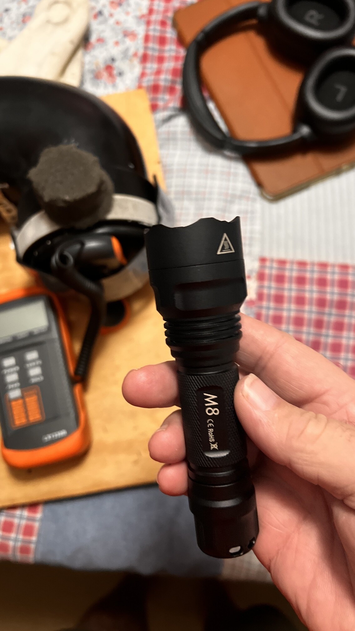

While talking to my friend about C8 flashlights I was perusing my shelves and discovered I still have a Jaxman M8, a mini C8. But the old 14 chip driver I built some time back was flickering. Decided to rework it.
This light has a brass screw-in light engine, but no retaining ring or threads even to hold the driver… it was soldered in. So I desoldered and removed the driver, heated the pill and broke loose the 20mm copper star with XP-L Hi. (I had glued the star in with thermal epoxy, heated it and punched it out from inside)
Prepped a 6A LD4 from Neven with a nice spring and 20 ga leads, reflowed an SFT40 onto a 20mm SinkPAD while simultaneously soldering the pad to the brass pill. Soldered the L4 in all around.
In Constant Current setting with an old 25R 18650 this little light makes 1360 lumens with a nice fairly tight beam.
Gotta love it when a plan comes together!
Forgot to mention, this was an interesting challenge to build as I was limited to the use of three fingers on my left hand due to the mod last week putting stitches in my middle and index fingers.
Frustrating at times but in the end the M8 is revived and quite nice. :sunglasses:
